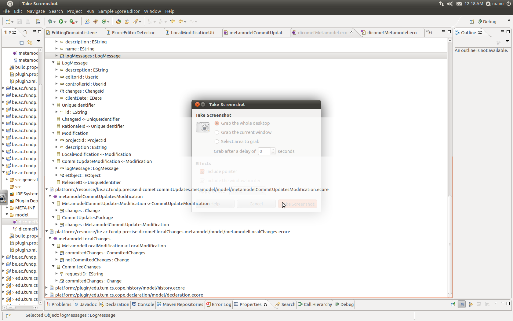

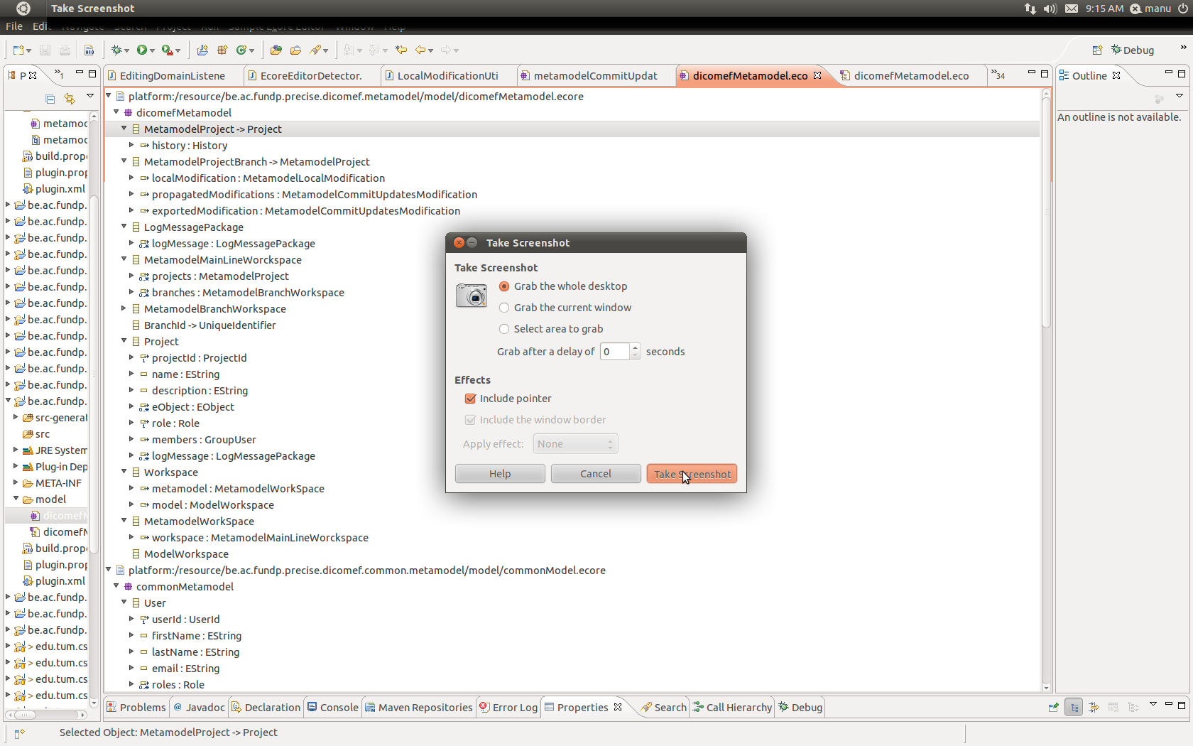

I use EDAPT to develop my tool. In my tool, I reference "Change" model element from from EDAPT. When I tried to generate a genmodel for my metamodel, I cannot add "declaration.genmodel" in referenced generator model.
When I validate the declaration.ecore file using a validation tool shifted with EMF editor, I have got a warning shown in attached file. I used a small example of metamodel which references "Change" in EDAPT and have got the same warning while generating a genmodel for it. Besides I cannot add "declaration.genmodel" in referenced generator model while I am generating a genmodel for my metamodel .
