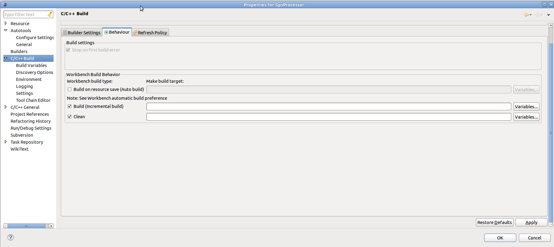

Why does my "Behavior" tab not include a "Use parallel build" checkbox?
The documentation implies it should:
http://help.eclipse.org/indigo/index.jsp?topic=%2Forg.eclipse.cdt.doc.user%2Freference%2Fcdt_u_prop_build.htm
The attached file shows what I see:
index.php/fa/4153/0/
Thank you,
Chris

I'm not sure where it went. There are problems with it since it was very make specific. And yes, the documentation is probably out of date. We haven't had people contribute to it in a while.
You can add the -j option to the build command yourself by overriding the build command.

It looks like you have an Autotools project and maybe not a vanilla C/C++ project. Apparently the parallel build options don't appear for Autotools builds, there is a feature request in the bug tracker to make this work properly
The workaround appears to be manually adding "-j" to the make command line
