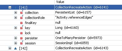

Can you set a breakpoint and then check which many-to-one (of which class/entity) is handled by the
ManyToOneType (method call to nullSafeSet()) in the stack trace? If you set the breakpoint where
the exception is thrown you can go back in the stacktrace and inspect the members there.
gr. Martin
Markus Bischof wrote:
> Ok...I hope I have the correct one:
> I went through the code and I found out, that the flush-method fails (not
> the save-method) in the HibernateResource-object
> Line 349: mySessionWrapper.flush();
> Then in the flush()-method of the SessionImpl-class, the onFlush()-method of
> a DefaultFlushEventListener-class is called, which calls a
> performExecutions(...)-method of the AbstractFlushingEventListener.
> Line 27: performExecutions(source);
> This method calls the method executeActions() of the ActionQueue-class
> Line 298: session.getActionQueue().executeActions();
> which calls some executeActions(...)-methods, where the
> executeActions(collectionCreations)-method fails!
> Line 143: executeActions( collectionCreations );
> This operation fails for the 141th item in the collectionCreations-list,
> which has the collectionRole "Activity.referenceEdges".
> I've attached a picture of the variables-view.
> How can I give you more information??!?! I guess this is not exactly what
> you ment...
> Regards,
> Markus

Re: [Teneo+Hibernate] TransientObjectException while saving a resourc [message #604424 is a reply to message #78672] |
Fri, 06 April 2007 09:57  |
Eclipse User |
gr. Martin
> you ment...
