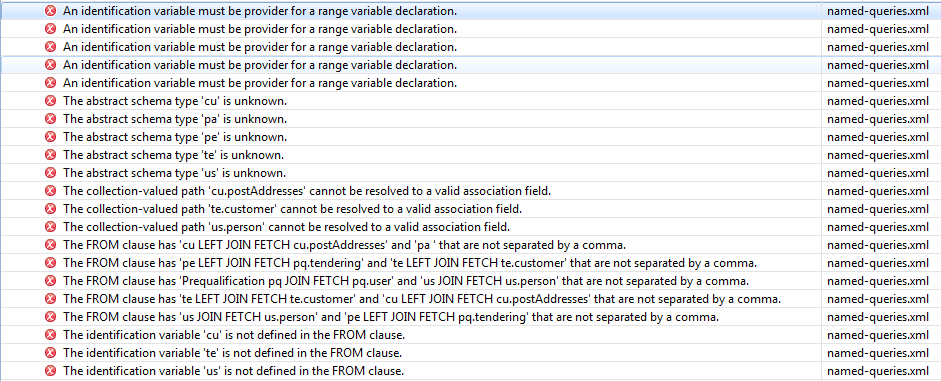

Re: validation error [message #863276 is a reply to message #729659] Sun, 29 April 2012 07:11 Go to previous messageGo to next message
has this really been fixed? I'm getting
index.php/fa/8137/0/
on
    <query>
      SELECT pq
        FROM Prequalification pq
        JOIN FETCH pq.user us
        JOIN FETCH us.person pe
        LEFT JOIN FETCH pq.tendering te
        LEFT JOIN FETCH te.customer cu
        LEFT JOIN FETCH cu.postAddresses pa
      WHERE pq.id = :pqId
      GROUP BY pq.id
    </query>
and I've performed a full Eclipse software update recently (2012-04).
Is this a bug? (if so, the error message also needs to be fixed: "... must be provideR ...")
Karsten
Re: validation error [message #865865 is a reply to message #863276] Mon, 30 April 2012 12:09 Go to previous messageGo to next message

Re: validation error [message #866419 is a reply to message #729089] Mon, 30 April 2012 18:02 Go to previous messageGo to next message
The previously mentioned issues on this thread have been fixed in the most recent service release, but your case appears to be unrelated to those.
At a glance, it would appear your query is not valid JPQL, and this would result in the errors you are seeing.
From the JPA 2.0 spec:
"The syntax for a fetch join is
fetch_join ::= [ LEFT [OUTER] | INNER ] JOIN FETCH join_association_path_expression
The association referenced by the right side of the FETCH JOIN clause must be an association or element collection that is referenced from an entity or embeddable that is returned as a result of the query. It is not permitted to specify an identification variable for the objects referenced by the right side of the FETCH JOIN clause, and hence references to the implicitly fetched entities or elements cannot appear elsewhere in the query."
Neil
Re: validation error [message #867554 is a reply to message #866419] Tue, 01 May 2012 06:59 Go to previous messageGo to next message
I'm pretty sure the JPQL is correct, also the statement simply works, returning the entities as expected.
I'm not sure what an identification variable is, but all JOIN FETCH expressions to the right are regular @XToX relationships to entities, the code for the entities was/is generated and is pretty much tested AND working.
I have just reverted to showing an ERROR on invalid JPQL, strangely the errors I couldn't get rid of originally now don't appear at all. Confused
Karsten
Re: validation error [message #867849 is a reply to message #867554] Tue, 01 May 2012 10:10 Go to previous messageGo to next message
Some JPA providers may go beyond the spec and provide support for these variable declarations. The JPQL validation in Dali is extensible, so depending on what type of JPA Platform you are using, you probably want to contact that provider and file a bug so they can customize this validation for their implementation of the spec.
Turning down the JPQL validation is what I would recommend, as you have suggested, until this issue can be fixed by your platform provider.
Neil
