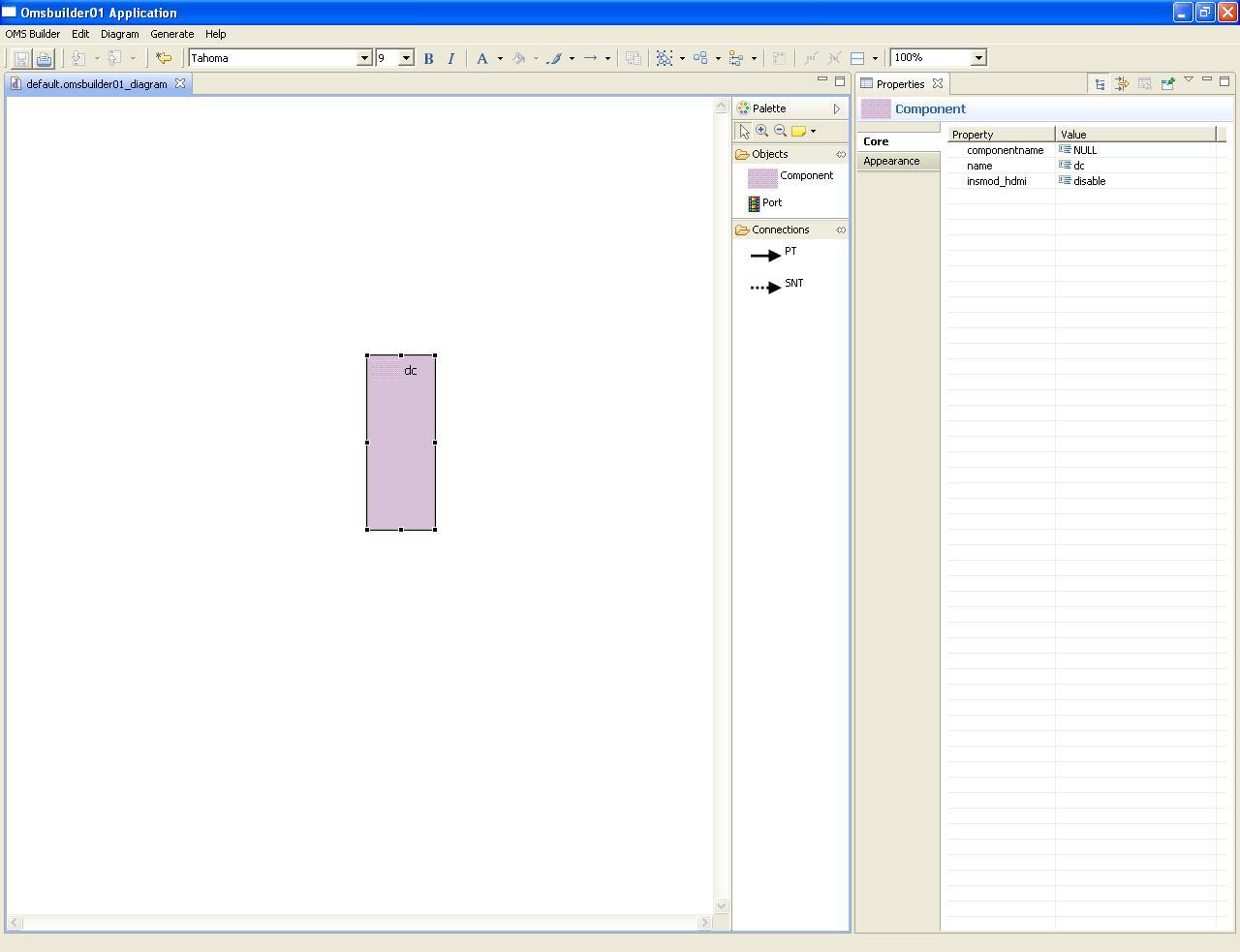

Hi All,
XML generated by the gmf editor contains all the parameters for Node though its not present in the property window.
Please find the attached xml file and the image with this.
Can anyone help me regarding this ?

Hi Vinay,
you can control within the emf gen model which attribute shall be
visible or editable within the properies view. GMF uses the generated
..edit project results manifested as *ItemProvider. Please consider the
emf project help for further details.
Sven

Please read and improve the following documentation,
http://wiki.eclipse.org/Graphical_Modeling_Framework/FAQ#How_can_I_customize_the_properties_view.3F
