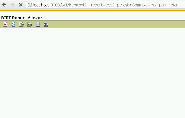

I am trying to run the birt.war of the Eclipse BIRT project in virgo using the latest tomcat release.
It installs and I can access the start page of the war: http://localhost:8080/birt/
When trying to acces the test report ("View Example" at the bottom), the browser will wait indefinitely for a result...
THe same war works when deploying to tomcat 5.5., for example.

I have already set the WABHeaders to "defaulted".
When I press "View Example", I get a response, but the browser is still waiting for more content to be shown.
Did you compare the output with that of a pure tomcat deployment?

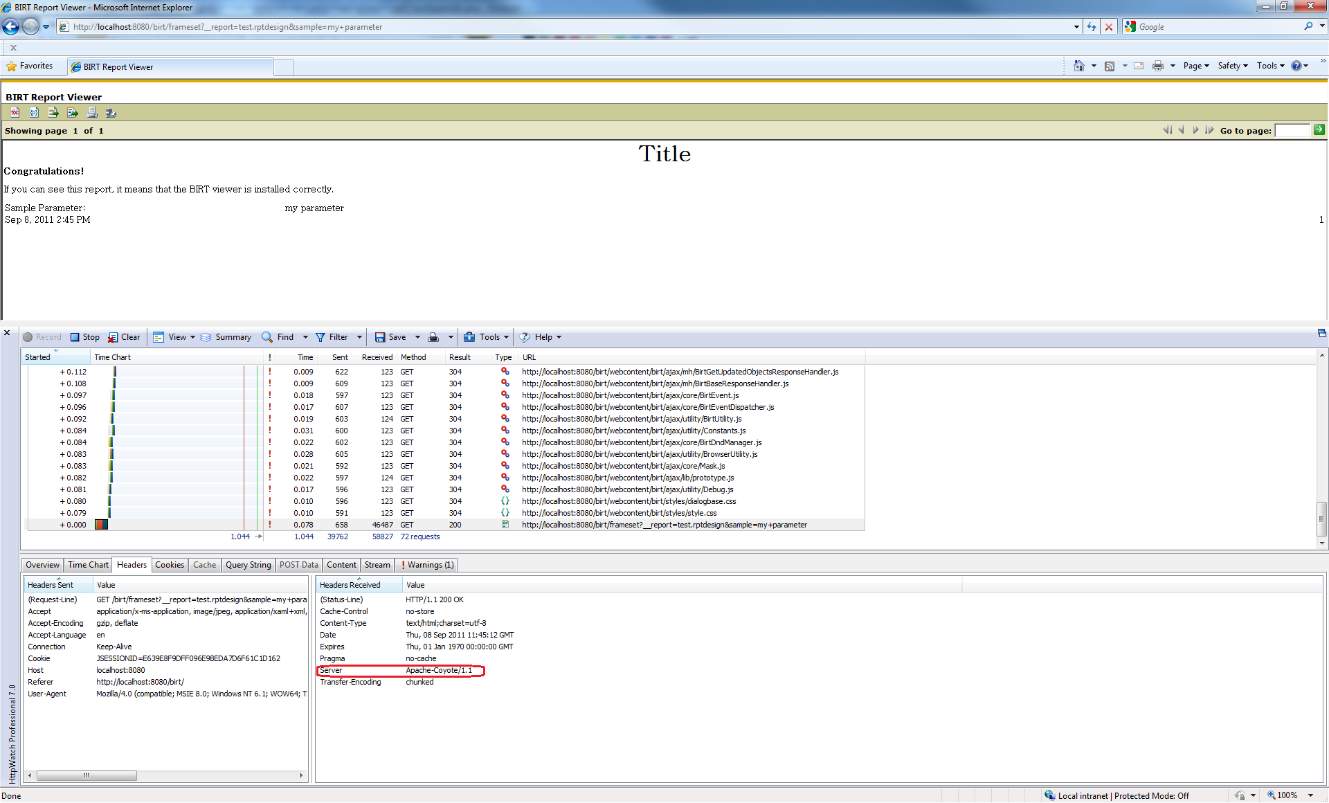

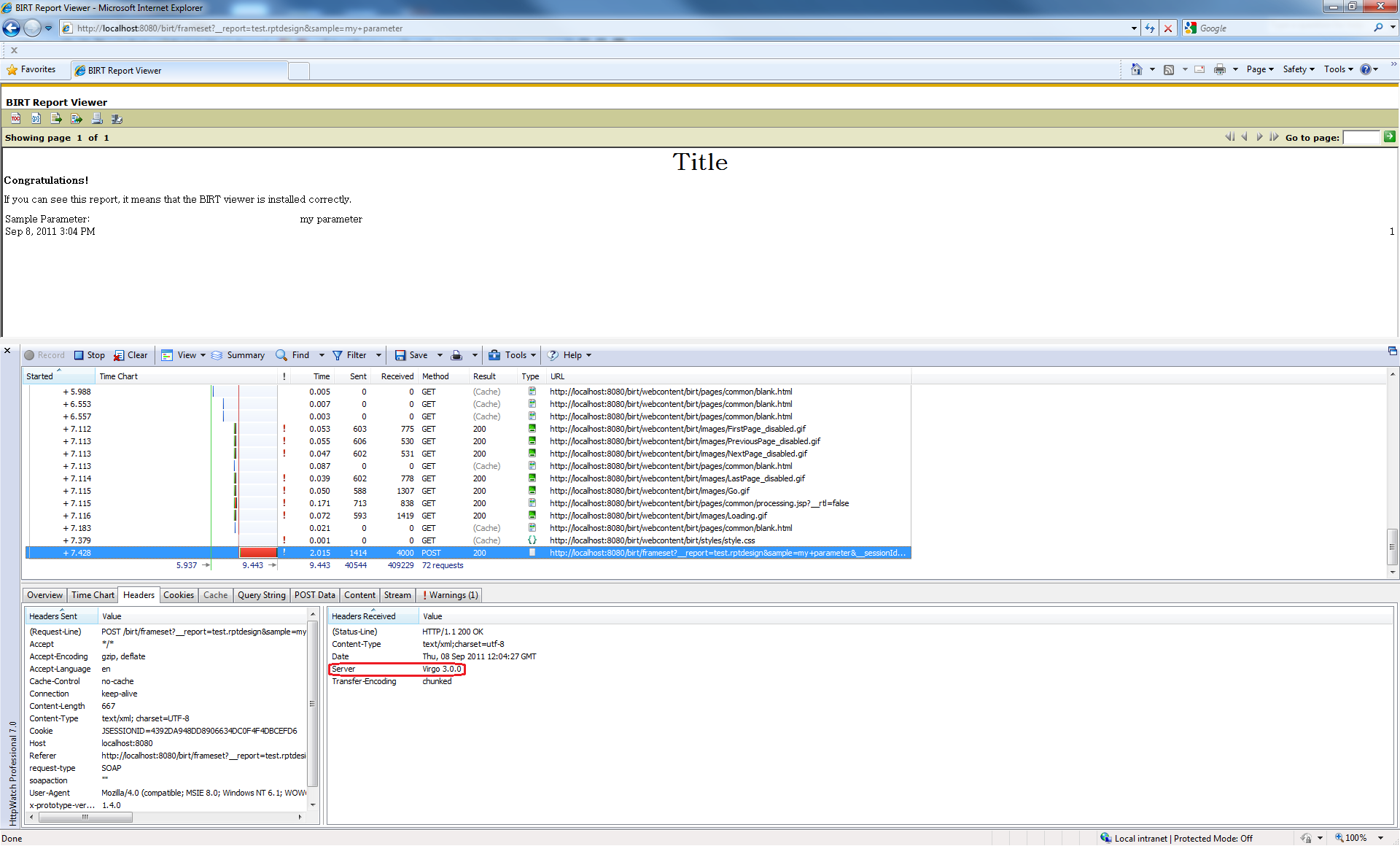

Re: birt.war does not run properly [message #723379 is a reply to message #723284] Thu, 08 September 2011 08:40 Go to previous messageGo to next message
here is what I can see on pure Tomcat 7.0.12 and on Virgo 3.0.0

I just re-installed tomcat virgo release (unzipping it into c:\virgo), changed the WABHeaders, copied the birt.war (3.7) into the pickup folder, and this is the only thing I can see when running the birt example:
index.php/fa/3904/0/
Note: the browser keeps waiting for the document to be read fully but does not finish...
I tried with Chrome 13.0 and IE 6.0...
I am not sure how to debug this...

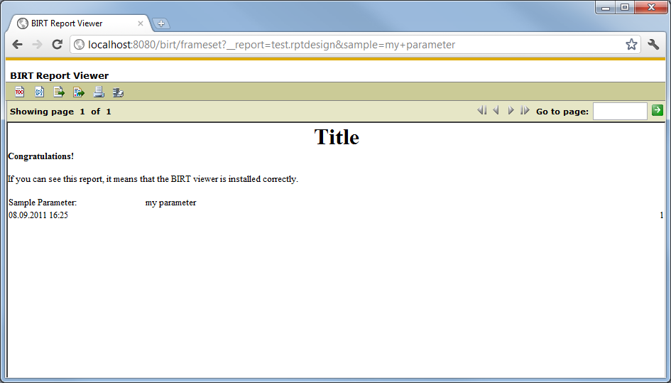

Re: birt.war does not run properly [message #723407 is a reply to message #723398] Thu, 08 September 2011 09:34 Go to previous messageGo to next message
Ok I'm receiving a correct response also on Chrome 13 (see attachment)
I would recommend you to use some HTTP Watch program to trace the http request (see my previous post's attachments where I'm using such program)
