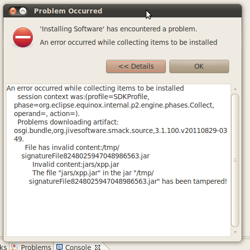

Hello, All!
I try to install ECF-plugin 3.5.2 over Eclipse Indigo (Ubuntu 10.04, Eclipse SDK, Version: 3.7.0, Build id: I20110613-1736). But I have an error message (see screenshot). I think, problems with jabber-protocol.
I try install software from zip-file. Again the same error.
Help me, please.
index.php/fa/3864/0/
  • Attachment: error.png
    (Size: 51.37KB, Downloaded 1384 times)
Re: A problem with install ECF 3.5.2 [message #727712 is a reply to message #722064] Wed, 21 September 2011 17:09 Go to previous messageGo to next message
Greetings,
I know the thread is old but I see it still has no answer...
I have the exact same problem on Windows XP SP3 on both Eclipse Helios and Indigo. Following the guide EIG:Add_to_Target_Platform which means deselecting "include required software" gives the error, but installing from Help->Install new software does not. However I'm not sure if it's ok to install it that way.
Has anyone found a solution yet?
Cheers

Re: A problem with install ECF 3.5.2 [message #729904 is a reply to message #729450] Tue, 27 September 2011 05:03 Go to previous message
I don't think I understand what you mean by
what does your runtime target platform look like after installing via
Help -> Install new software?
I have to say, ECF apparently works as I ran multiple examples and none failed, but I had to install it not as the guide said, so I was wondering if that may lead to future issues.
