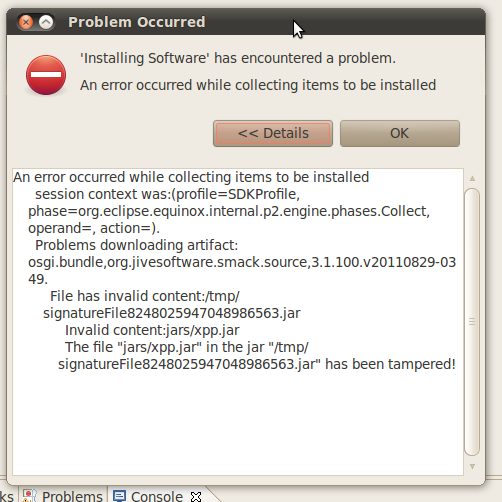

Hello, All!
I try to install ECF-plugin 3.5.2 over Eclipse Indigo (Ubuntu 10.04, Eclipse SDK, Version: 3.7.0, Build id: I20110613-1736). But I have an error message (see screenshot). I think, problems with jabber-protocol.
I try install software from zip-file. Again the same error.
Help me, please.

Greetings,
I know the thread is old but I see it still has no answer...
I have the exact same problem on Windows XP SP3 on both Eclipse Helios and Indigo. Following the guide EIG:Add_to_Target_Platform which means deselecting "include required software" gives the error, but installing from Help->Install new software does not. However I'm not sure if it's ok to install it that way.
Has anyone found a solution yet?

Hi Stefano,
what does your runtime target platfrom look like after installing via
Help -> Install new software?
Markus

I don't think I understand what you mean by
what does your runtime target platform look like after installing via
I have to say, ECF apparently works as I ran multiple examples and none failed, but I had to install it not as the guide said, so I was wondering if that may lead to future issues.
Looking at Installation details->Installed software I see (among others):
ECF Remote Services Target Components	3.5.2.v20110829-0349	org.eclipse.ecf.remoteservice.sdk.feature.feature.group
    ECF Datashare	1.0.0.v20110829-0349	org.eclipse.ecf.datashare.feature.feature.group
    ECF Discovery	1.0.0.v20110829-0349	org.eclipse.ecf.discovery.feature.feature.group
    ECF Discovery DNS-SD Provider	1.0.0.v20110829-0349	org.eclipse.ecf.discovery.dnssd.feature.feature.group
    ECF Discovery SLP (RFC 2608) Provider	1.0.0.v20110829-0349	org.eclipse.ecf.discovery.slp.feature.feature.group
    ECF Discovery Zeroconf Provider	1.0.0.v20110829-0349	org.eclipse.ecf.discovery.jmdns.feature.feature.group
    ECF Discovery Zookeeper Provider	1.0.0.v20110829-0349	org.eclipse.ecf.discovery.zookeeper.feature.feature.group
    ECF Distributed EventAdmin	2.0.0.v20110829-0349	org.eclipse.ecf.eventadmin.feature.feature.group
    ECF Distributed EventAdmin Examples	1.0.0.v20110829-0349	org.eclipse.ecf.eventadmin.examples.feature.feature.group
    ECF Generic Server	1.0.0.v20110829-0349	org.eclipse.ecf.server.generic.feature.feature.group
    ECF OSGi 4.2 Remote Services Admin	2.0.1.v20110829-0349	org.eclipse.ecf.osgi.services.feature.feature.group
    ECF OSGi 4.2 Remote Services Examples	1.1.0.v20110829-0349	org.eclipse.ecf.remoteservice.examples.feature.feature.group
    ECF Remote Services	1.0.0.v20110829-0349	org.eclipse.ecf.remoteservice.feature.feature.group
    ECF Remote Services R-OSGi Provider	1.0.0.v20110829-0349	org.eclipse.ecf.remoteservice.rosgi.feature.feature.group
    ECF Remote Services REST Support	1.0.0.v20110829-0349	org.eclipse.ecf.remoteservice.rest.feature.feature.group
    ECF Remote Services SOAP Support	1.0.0.v20110829-0349	org.eclipse.ecf.remoteservice.soap.feature.feature.group
    ECF XMPP Provider	1.0.0.v20110829-0349	org.eclipse.ecf.xmpp.feature.feature.group
