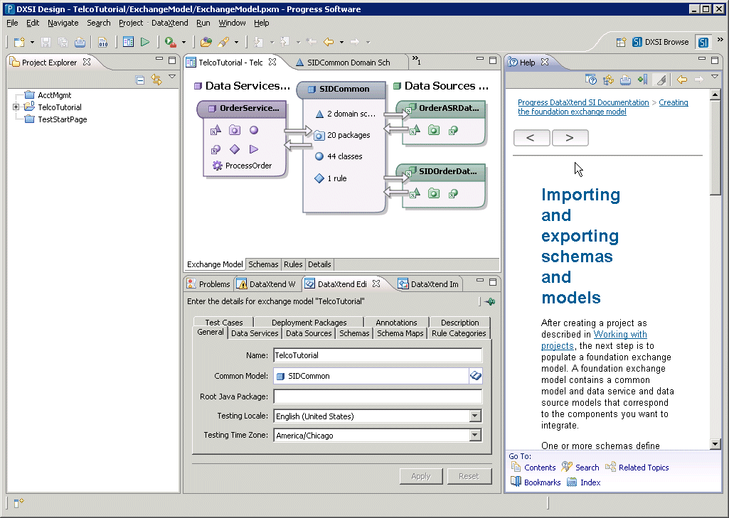

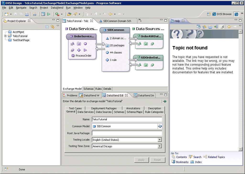

3) The problem is that when you press F1, the links do show up, but when you follow a link, I get two buggy behaviors:
A) For the first link, the content flashes in the help window, then, the message about a topic not being found appears.
B) For the second link, the opposite happens, first a message flashes about the topic not being found, then the help displays correctly.
I've attached two screen shots that illustrate problem B. I pressed nothing between the shots:
index.php/fa/3817/0/
index.php/fa/3818/0/
  • Attachment: ImageA.gif
    (Size: 77.57KB, Downloaded 1286 times)
  • Attachment: Image1.gif
    (Size: 77.78KB, Downloaded 1332 times)
