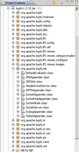

Re: Eclipse Error - org/apache/log4j/net/JMSSink [message #722677 is a reply to message #719221] Tue, 06 September 2011 10:08 Go to previous messageGo to next message
I found the jar file from internet and added into my builtpath. The result is the same. you can see the screenshots from from my project in the attachment.
But, before; I was not supposed to add this jar file into my builtpath. I don't know what happened but has cost me several weeks to solve, and there is still no solution until now.
Comments for solution will be highly appreciated.
