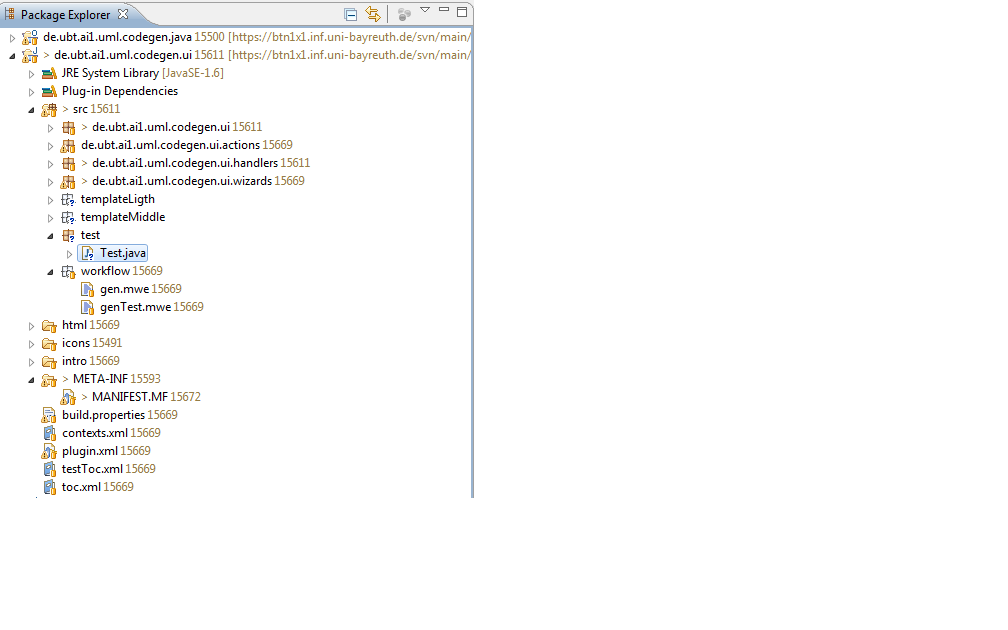

hi to all
i'm trying to start my xpand workflow from a plugin (using the org.eclipse.emf.mwe.core.WorkflowRunner)
the mwe-file is in the plugin-project (like all other things i need for the codegen)
when i start the mwe-file by rigth click all runs fine (the same when i start it from code in the plugin) but when i want invoke it from the plugin nothing happens no errors just false from the workflow.run(...)
thats my manifest-file:

a picture is appended which shows the structure of my plugin-project
thanks for any help
