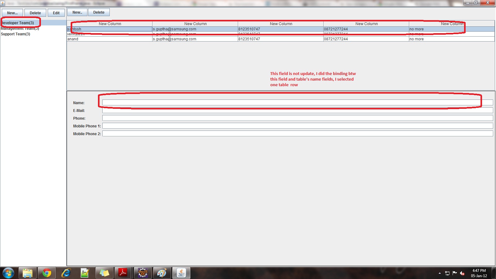

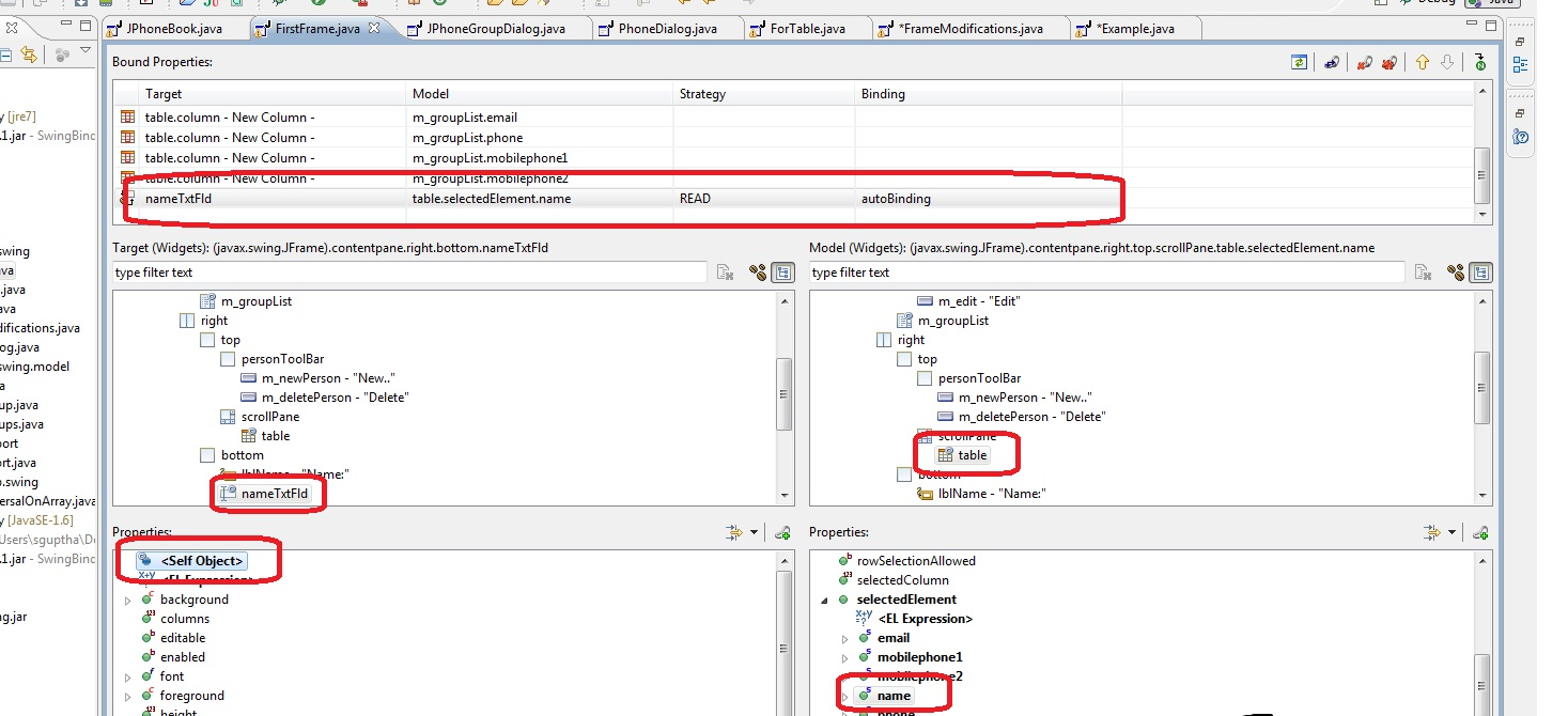

This is related to Swing Binding example,
I did the binding between text fields and table, but when I select a row on the table, the text fields are not not getting updated, Do I need to add any code for the source ?? If yes, Please let me know where to add that.
I am trying to develop the same application that was given in SwingBinding tutorial,
I spent 3 days on this, till now I didn't get any answer to it.
Please help me on this.
Thanks in advance.

Re: JList data binding not working. [message #775186 is a reply to message #775151] Thu, 05 January 2012 09:22 Go to previous messageGo to next message
You have not provided any example code, so how could I possibly know what code you might be missing?
Full source code is provided with the Swing Data Binding example, so why not just take a look at that?
Re: JList data binding not working. [message #775504 is a reply to message #775186] Fri, 06 January 2012 00:55 Go to previous messageGo to next message
I had seen the source code, the problem is there is no documentation for the code to understand why he wrote AbstractModelObject class, And I don't know about firepropertychange method. To bind table's parameter to textfield do I need to write this method ??
However as per my knowledge, when the table fields table fields are getting populated the binded textfields should also get populated as I did binding through binding tab. Am I wrong ?? Please let me know.
Re: JList data binding not working. [message #775699 is a reply to message #775504] Fri, 06 January 2012 09:42 Go to previous message
I can't tell you what is wrong with your code without actually seeing it. From your comments, all I can do is guess that your domain objects don't meet the requirements of the Swing Data Binding Framework (JSR 295). Your domain objects are your responsibility while WindowBuilder is only responsible for generating the data binding code in your UI class. If you aren't understanding the domain objects provided with the tutorial, you should review the requirements of the Swing Data Binding Framework with respect to domain objects. This forum is not the place to learn that framework or ask general questions about it. WindowBuilder assumes that you are already familiar with it, so one suggestion is to build a small example by hand so that you understand it from start to finish. You can certainly start with the code provided in the tutorial as that is complete and includes a complete set of domain objects (including an AbstractModelObject you can use as the parent for your domain object classes).
