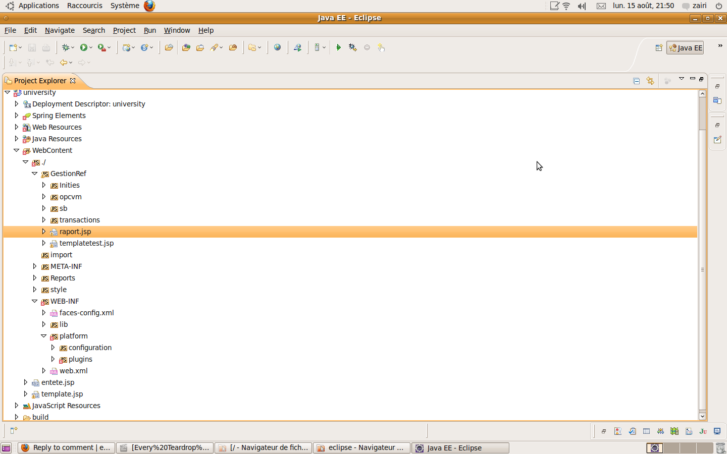

Re: report doesn't show up [message #715902 is a reply to message #715894] Mon, 15 August 2011 18:02 Go to previous messageGo to next message
i'm using Birt 2.5 and Birt runtime 2.5.0
i added an image of the hierarchy of my JSFproject:
the package cdvm.surv.web is in the src of my JSF project.
  • Attachment: Capture-1.png
    (Size: 106.99KB, Downloaded 210 times)
Re: report doesn't show up [message #715907 is a reply to message #715902] Mon, 15 August 2011 18:40 Go to previous messageGo to next message
Can you set the log level to FINE and see if you are getting anything in
the logs. My guess is that class in your open script is not being
found. Put something like this in the before factory to see if anything
is getting written out.
out = new PrintWriter( new FileWriter(
"/home/zairi/Bureau/myrowcount.txt", true ) );
out.println( "Some message");
out.close();
When deployed where is the source for the cdvm.surv.web package/
You may want to try the 3.7 runtime which does not have the
web-inf/platform directory and all the jars are in the web-inf/lib.
Jason

Re: report doesn't show up [message #715913 is a reply to message #715909] Mon, 15 August 2011 19:31 Go to previous messageGo to next message
In your list I did not see the jsf4birt lib. Is it in there?
Does this page work for any report or is it just failing on on scripted
datasource?
Jason

I've already added the jsf4birt jars
i added my Bean to the exadel-jsf4birt-demo src, and my report to its "Reports" file, and the dataset gets the list from the Bean, still it gaves some errors though, but at least this is a part of the problem resolved, I have to raplace the file "Reports" of my JSFproject and see what that will come up with.
thank you Jason
Re: report doesn't show up [message #716061 is a reply to message #715914] Tue, 16 August 2011 07:33 Go to previous messageGo to next message
it seems that the report's script cannot be compiled even if I have the js jar in my lib.
