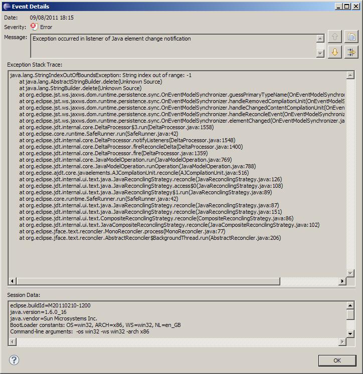

As titled, such exception is thrown every time when I try to save any .aj file after modification. The details of the exception is attached. This problem occurs in Eclipse 3.6 and its later version, whereas it works fine in 3.5.1.
index.php/fa/3605/0/
index.php/fa/3606/0/
Does anyone know what is the cause and how to fix it? I am looking for the solution. Thanks in advance.

Do you have a sample project that you can send over so we can look at it? The exception is happening in WTP, but it could be originally caused by something in AJDT. Since the problem spans multiple Eclipse projects, there's not much that I can do unless I have a way to recreate the failure.
What kind of project are you using? Obviously. it is an AspectJ project, but what other kinds of natures does it have?

Re: StringIndexOutOfBoundsException is caught when modifying any .aj file [message #714605 is a reply to message #714601] Wed, 10 August 2011 23:47 Go to previous messageGo to next message
This is a bug with the org.eclipse.jst.ws.jaxws.do.runtime project.
Here is the code of the method that is giving you the trouble:
	protected String guessPrimaryTypeName(ICompilationUnit cu)
		final String parentName = cu.getParent().getElementName();
		final StringBuilder assumedPrimaryTypeName = new StringBuilder();
		if (parentName.length() > 0) {
			assumedPrimaryTypeName .append(parentName).append('.');
		return assumedPrimaryTypeName.append(cu.getElementName()).
			delete(assumedPrimaryTypeName.lastIndexOf(".java"), assumedPrimaryTypeName.length()).toString();//$NON-NLS-1$
Notice that in the return statement, there is the assumption that the file name ends in ',java'. Obviously, this will not work for '.aj' files (or '.scala' files, or '.groovy' files, etc). They need to fix this.
