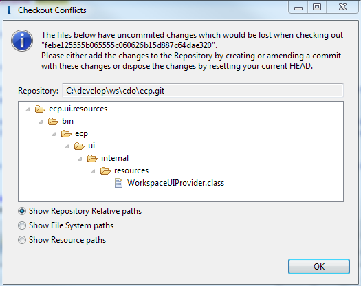

Making my first steps with Git i'm stumbling about the fact that Git/Egit (can not really distinguish that for now) againa and again claims that some binary derived files are NOT ignored, see attached screenshot. Multiple times I have selected "Igore" from the Git menu on all my bin/ folders. Seems to have no effect. Is it a bug in EGit or am I doing something wrong?

Hi Eike,
Did you by chance ever accidentally commit anything in your bin folder?
Because Git won't allow you to ignore further changes to any resource
already under its control.
If you have a Git console at hand, could you check what "git status" has to
say about that file?
What does the .gitignore in your project root and .git/info/exclude in your
repository root contain?
Best Regards,
Carsten

Re: Derived files like .class files [message #704476 is a reply to message #704093] Thu, 28 July 2011 13:16 Go to previous messageGo to next message
Am 28.07.2011 11:17, schrieb Carsten Reckord:
> Hi Eike,
Yes, I'm sure about that. At the beginning I did not even think about it because I thought that the global team ignores are respected.
That would explain it. How can I get rid of them now?
It contains "bin/".
>> Hi Eike,
You can find a basic howto here:
http://progit.org/book/ch6-4.html#removing_a_file_from_every_commit
However, be warned that this will rewrite every commit containing that
file/folder and it's a baaad idea to rewrite commits that have already been
pushed to a public repository.
A less intrusive but also less thorough way would be to remove the file from
all branches with a new change by doing
git rm -r bin/
git commit
You should be good regarding everything past these commits, but you'll still
have trouble swiching to and from earlier commits from your history.
