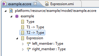

Re: oclIsTypeOf error with OCLinEcore [message #702799 is a reply to message #702710] Tue, 26 July 2011 16:19 Go to previous messageGo to next message
Here we are, I tried to make a very simple example to explain what I want.
Type is an abstract class with two children, T1 and T2.
Expression is a class with two eReferences, left_member and right_member, which can be T1 or T2.
When I create a dynamic instance of Expression, I give it its two members (left and right). My goal is to check with OCL if both of them belong to the same type (i.e, for instance, within the Expression context, self.left_member.oclIsTyeOf(T1)=true and self.right_member.oclIsTyeOf(T1)=true)
My problem is oclIsTypeOf() operation, as I said before...
self.left_member.oclIsTyeOf(T1) does work, it evaluates the type of left_member and writes it, but I can't compare it with the right_member type...
index.php/fa/3486/0/
thanks
  • Attachment: example.jpg
    (Size: 57.50KB, Downloaded 877 times)
[Updated on: Tue, 26 July 2011 16:23] by Moderator

Re: oclIsTypeOf error with OCLinEcore [message #703202 is a reply to message #703098] Wed, 27 July 2011 05:32 Go to previous messageGo to next message
here is what I have for my .ecore metamodel.
abstract class Type;
	class T1 extends Type;
	class T2 extends Type;
	class Expression
		property left_member : Type[1] { ordered composes };
		property right_member : Type[1] { ordered composes };
I meant that when I use the oclIsTypeOf() operation in a simple context, it works. I'll try to explain it clearly :
I instanciated the Expression class using the dynamic instance creation, then I gave it a left member and a right member, I chose to give to both of them the same type : T1.
As I said above, oclIsTypeOf() operation works fine if I use it in this way :

As I wrote, the non-Xtext Console doesn't support oclType().
What do you mean by doesn't recognize the dot?
self.left_member.oclIsTypeOf(self.right_member.oclType())
which seems to be recognizing the dor four times.
Ed Willink
On 27/07/2011 19:33, fafanellu wrote:
> Hi, I don't use the Xtext console, since it doesn't recognize the "."
> (dot). So, I use the "normal" OCL console.
> I always get the same thing...
> Evaluating:
> Results:
> Cannot find operation (oclType()) for the type (Type)
> Damn...
> Maybe it's because whent I first tried to do the tutorial, I clicked
> "Yes" when I was asked if I wanted to add the Xtext nature for the
> project ?
> It was said "Click Yes to avoid answering the question in the
> future"...so I did it. Maybe I should try to cancel this (how?).
> Anyway, my final goal is to add a constraint directly in the .ecore
> model...maybe oclType() will work in this case ?
> thanks :)
Re: oclIsTypeOf error with OCLinEcore [message #704124 is a reply to message #703712] Thu, 28 July 2011 05:51 Go to previous messageGo to next message
Well, when I start to type in the "normal" console "self.", I am proposed some things after the dot : left-member, right_member, and some OCL operations.
In the Xtext console, I am not, so I thought it didn't work.
But I've just tried to write my code "manually", and it works well !! Smile
Thanks !!
I'm now trying to integrate it in the .ecore metamodel, as a class invariant (is this a class invariant ?).
Again, I thank you for your help Smile
Re: oclIsTypeOf error with OCLinEcore [message #704416 is a reply to message #704124] Thu, 28 July 2011 11:39 Go to previous messageGo to next message
Xtext offers no completion after "." by default since the choice can be
massive. Customizing this is one of many
editor improvements that might happen for Juno. If you type "xxx.a" then
backup to the dot you do get
some completions; can't promise that they're accurate.
Ed Willink
> But I've just tried to write my code "manually", and it works well !! :)
> Thanks !!
> Again, I thank you for your help :)
Re: oclIsTypeOf error with OCLinEcore [message #704427 is a reply to message #704416] Thu, 28 July 2011 12:02 Go to previous message
Ok thanks, I'll try this out !
I'll be back soon for some help, I think...
Have a nice day
regards
Stephane
