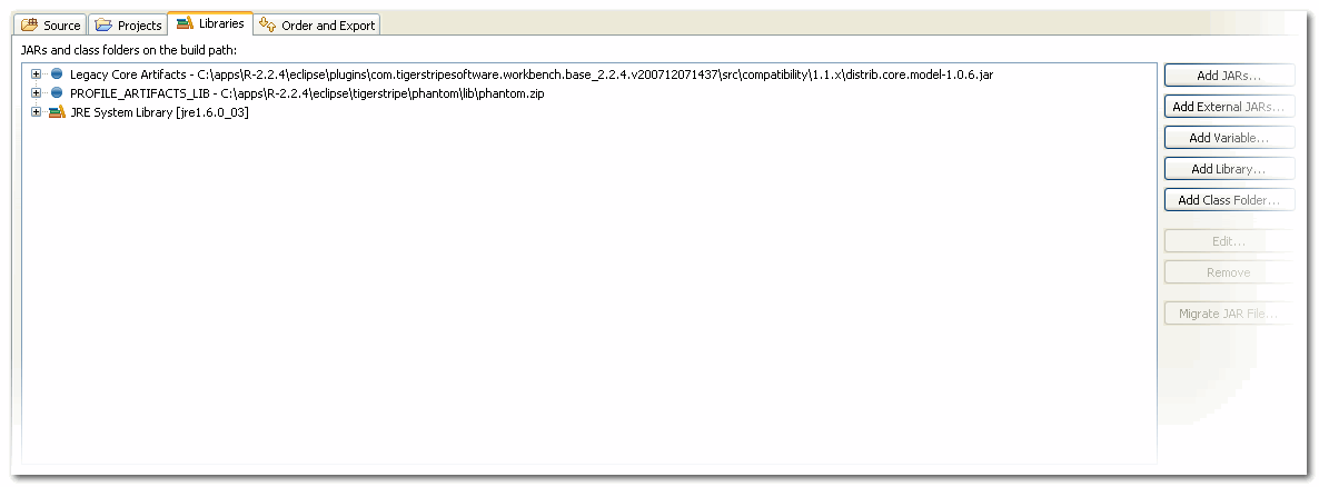

In the Tigerstripe Explorer, highlight the project (fm_model), and hit
Alt-Return. This will bring up the properties about this project.
Select the Java Build Path section, and inside there the "Libraries" tab.
You will need to make sure that you get correct references for these
variables:
- "Legacy Core Artifacts"
- PROFILE_ARTIFACTS_LIB.
They should have been updated by TS upon upgrade but I suspect something
went wrong.
They should look like the picture attached.
First of all I'd try to stop Eclipse and restart it, hopefully whatever went
wrong the first time around will fix itself. If not, you should be able to
edit them so that they are valid.
Note that the goal is to get both variables fixed. Then all TS project
(since they use these variables) should be OK after a rebuild.
Let me know how that goes.

Re: Errors using TS 2.2.4 [message #562069 is a reply to message #6406] Thu, 06 March 2008 11:16 Go to previous message
Hi Marc,
Hmmm... Not too sure about what happened. I suppose you upgraded Eclipse +
Tigerstripe but kept the same workspace? I wonder if TS got its wires
crossed.
Anyway, you should be able to fix this.
variables:
went wrong.
Eric
