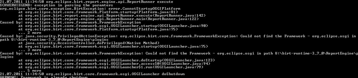

hello,
i downloaded the birt-runtime-3_7_0 to create a report via console.
my command looks like this:
U:\birt-runtime-3_7_0\ReportEngine\genReport.bat --mode runrender --parameter "MitarbeiterID=1" --output "C:\Documents and Settings\mag7rt\Desktop\output.pdf" --format PDF "U:\workspace-birt\SDBReport\EmployeeReport.rptdesign"
at the first time i ran this command there were some errors:
21.07.2011 11:11:08 org.eclipse.birt.report.data.oda.jdbc.JDBCDriverManager loadExtraDriver
SCHWERWIEGEND: DriverClassLoader failed to load class: oracle.jdbc.OracleDriver
java.lang.ClassNotFoundException: oracle.jdbc.OracleDriver
the pdf file was created on the desktop, but without the data from the database...
i searched on google and i found some solutions... (cant post link)
so i copied the folder "org.eclipse.birt.report.data.oda.jdbc_2.6.2.r262_v20110127" with his content from my eclipse-birt/plugins folder to the birt-runtime-3_7_0\ReportEngine\plugins folder and ran the command again...
and it said:
index.php/fa/3420/0/
this time it doesnt create the pdf file on my desktop
so i decided to copy the following three files from eclipse-birt/plugins to birt-runtime-3_7_0\ReportEngine\plugins
- org.eclipse.osgi.services_3.2.100.v20100503.jar
- org.eclipse.osgi.util_3.2.100.v20100503.jar
- org.eclipse.osgi_3.6.2.R36x_v20110210.jar
now it says:
index.php/fa/3421/0/
and no pdf file...
i have no idea what to do...
can somebody help?
thx!
  • Attachment: Console1.JPG
    (Size: 79.89KB, Downloaded 3278 times)
  • Attachment: Console2.JPG
    (Size: 17.37KB, Downloaded 3131 times)
Re: problem with birt-runtime [message #699449 is a reply to message #699295] Thu, 21 July 2011 10:45 Go to previous messageGo to next message
The only thing you should have had to do was add the oracle jdbc driver
to the classpath. Undo all the previous changes and edit the
genReport.bat and add it to this line:
SET
BIRTCLASSPATH=%BIRT_HOME%\ReportEngine\lib\com.ibm.icu_4.4.2.v20110208.jar;...
Jason

Re: problem with birt-runtime [message #701612 is a reply to message #699449] Mon, 25 July 2011 06:12 Go to previous messageGo to next message
wow it works!
thanks a lot!!! (:
