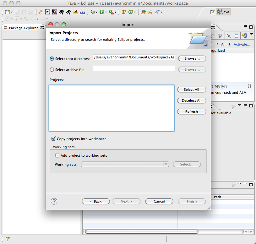

I click on File>Import>Existing Projects into Workspace. Then I browse to the Assignment1 folder (under Select root directory), but when I select the Assignment1 folder, no projects appear (even though there are lots of files in the Assignment1 folder), and it doesn't let me import anything at all.
So I'm not able to import any of the assignments, worlds, or background necessary to do the assignment. Any suggestions?

Those projects you think you have under Assignment 1 aren't Eclipse
projects. For this reason, you'll need to create a new project (Java
Project, Dynamic Web Project, etc.), then on the wizard's first page,
designate Assignment 1/project as the source for the project. Eclipse
will then create .project, .classpath, etc. in that project and it will
become an Eclipse project.

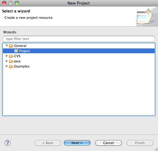

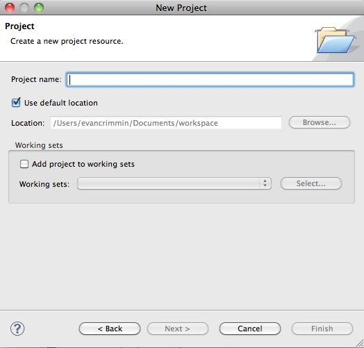

I tried to create a new project, but it wouldn't let me for some reason (the "finish" tab is grayed out).
I took some screen shots of the steps that I took to start a new project--File>New>Project then General>Project>Next, then gave it a name (Assignment1), but it's not letting me finish.

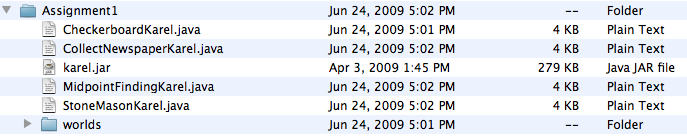

Also here are the example files that live in the Assignment1 folder that I'm trying to put into Eclipse (they are .java, .jar., and .w)

Choose a Java Project rather than a generic Project.
This said, under Assignment 1, you don't have any kind of Java project,
but just Java sources and a JAR. This wouldn't be legitimate even for
command-line javac.
In order to make an Eclipse Java Project, create a new Java Project,
with the name you want (maybe Assignment-1?), then create a package (or
packages) under the src subdirectory that corresponds to the package
directive inside your Java file(s). Right-click on a package, choose
New..., then Class and give it the name of one of your Java files. Copy
the contents of that file into the new one. (There are more
sophisticated ways to achieve this, but they're usually frustrating.)
Add a lib subdirectory to the root of your project and copy the JAR file
to it. Right-click on the project and choose Build Path -> Configure
Build Path -> Libraries -> Add JARs to add that JAR to your project
(you'll navigate to find it under that lib subdirectory you created).
Basically, I've told you here how to create a project from scratch
because your "project" on disk aren't really projects at all.

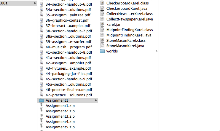

I have tried a lot now (total newbie just started the CS106A stanford online course) and I think I got something working:
I did like this:
1. download "assignment 1" from the Stanford site.
2. As the zip file is automatically unzipped in the download folder (on mac OS Lion), I moved the folder to the desktop, right clicked the folder, selected "compress assignment 1", then I had the zip file again.
3. In Eclipse (I use Indigo Service Release 1 - couldn't get the Stanford version to run on Lion) choose File --> Import --> General --> Existing Project into workspace --> select archive file --> browse --> assignment 1.zip (the one you compressed above) --> open.
After this I can write code and get it to work but only CollectNewspaperKarel.java! This I don't understand as assignment 1 has 4 smaller tasks, but no matter which of the 4 I write in and choose it runs CollectNewspaperKarel.java. Frustrating but for now I just write the code for each sub assignment in the collectnewspaperkarel and try it that way.
Any ideas of what I do wrong in this last part?
