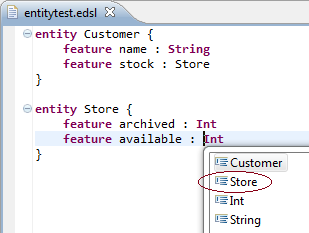

So here is a simple DSL similar to the one of the documentation. My questions are:
Image:[4]
  1. The type of a feature must not be the name of the entity wherein it is defined (so, no recursion allowed). This constraint can be easily implemented with a @Check in the validator, but it is then still contained in the proposal list.
    I assume one just has to adapt the scope provider, but I am still puzzled on how to use it properly. I think one has to start with a function as described in the documentation[2]:
    IScope scope_Feature_type(Type ctx, EReference ref)
    But how can I restrict the automatically created scope, or simply create a new one? Does the injected IScopeProvider offer help here? I think I nee something similar to this[3], but this code seems to use a rather old version.
  2. The type of the feature can either be a predefined (static) type, or a reference to an entity. Is there a more easy or elegant way to express this rule? How would you do it?
Any help is very appreciated. Thank you.

Re: Restricting the scope / code suggestion [message #697812 is a reply to message #697799] Mon, 18 July 2011 02:03 Go to previous messageGo to next message
as you said, the constraint can be enforced using the validator. In fact you *should* do it that way, as it allows for a meaningful error message ("a type is not allowed to be used in its feature list"). Solving it via scoping would give you "validation" and code completion out of the box, but how would you react as a user if you got the error message "could not resolve reference" if the thing you want to refer to is defined the line above?
You should override the corresponding code completion function. In fact, the resolveCrossReference-method has several signatures that allow for a filter to be passed. There you could filter out the context entity.
Typically you would not hard code base types in the grammar. The suggested way is the library approach. You ship a "common types"-model along with your language. Something like
entity String{}
entity Int{}
If your setup is correct, these entities are picked up by the index and are referrable as any entity the user defines. So you only need
Type: reference=[Enitity]
or rather
Feature: 'feature' name = ID ':' type = [Entity];
Alex

Re: Restricting the scope / code suggestion [message #697982 is a reply to message #697828] Mon, 18 July 2011 10:37 Go to previous messageGo to next message
Hi Alex,
thank you very much for your explanation and the hint to the code completion and the filtering methods.
In fact, I tried it the way you proposed and the concept for Content Assist[1] is much easier to understand than scoping (combined with debugging) Smile
I want to show the code that I used to make it more understandable for people coming to a similar issue. With the Validator and the ProposalProvider it pretty much does exactly what I was hoping for. Anyway I have a few further quetions.

  1. In the completeType_Reference function, both the context.currentModel and the model refer to the same object of type FeatureImpl. I indeed need this Feature (or its container) to complete the Type_Reference, but how does Xtext decides which model is passed? What if there are more Rules with references to Type?

Re: Restricting the scope / code suggestion [message #698064 is a reply to message #697982] Mon, 18 July 2011 13:51 Go to previous messageGo to next message
regarding 1) I can't give you the definition, but I can give you an idea. Usually when typing and using code completion, you have an incomplete model. The framework determines all possible continuations, i.e. valid semantic models with the given "document prefix". This is how different context objects are possible.
If there are different rules referring to Type, they would cause a different completion function to be invoked. Your job here would be to extract code to be used by all of them to helper methods.
