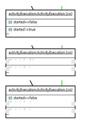

running against Ganymede, my GMF editors run just fine. However, after
upgrading to Indigo (I skipped Helios), I'm running into some problems,
and regenerating doesn't help...
Pictures say more than words, so I attached a jpg showing the problem.
The node to the top is how it should look like. The node to the middle
is how it looks on Indigo. Interestingly, if I add another "entry" to
the middle compartment, the result looks like the node at the bottom -
the newly added element is now hidden, and the already existing one
shows up.
Any idea what's going on here?
Thanks a lot in advance,
Chris

Hi again,
nobody?
If this is the case, can anybody maybe give me some advice on a)
possible causes for this and b) how to debug this?
Thanks in advance once again,
Chris

Ok, I've made some progress on my own. The horizontal scrollbar causes
the error. In my custom XXXCompartmentEditParts, I just override method
getFigure() like this to disable the scrollbar (which I don't need anyways):
public IFigure getFigure() {
ResizableCompartmentFigure result = (ResizableCompartmentFigure)
super.getFigure();
// workaround for a bug described here:
http://www.eclipse.org/forums/index.php/mv/tree/200734/640774/#msg_640774
result.getScrollPane().setHorizontalScrollBarVisibility(ScrollPane.NEVER);
return result;
More information can be found here:
Hope that this helps somebody...
