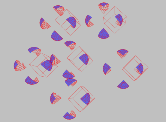

Hi all,
are there any SphereFigureShape examples?
I've tried to use it in ShapeFigure3D, but it seems like it can't be
rendered properly. See attached screenshot.
Am I doing something wrong?
Here is my code.
public class FeatureFigure3D extends ShapeFigure3D {
protected Shape createShape() {
SphereFigureShape sphereFigureShape = new SphereFigureShape(this, 3);
sphereFigureShape.setFill(true);
setAlpha(0xBB);
´ return sphereFigureShape;
Dennis.
  • Attachment: Bild 1.png
    (Size: 56.58KB, Downloaded 526 times)
Re: How to use SphereFigureShape [message #691094 is a reply to message #690838] Thu, 30 June 2011 13:26 Go to previous messageGo to next message
Originally posted by:
I found a solution:
in org.eclipse.draw3d.shapes.SphereShape
adding pos.setLocation3D(new Vector3fImpl(1f, 0f, 0f));
to static ROTATE_Z90 initialization does the trick.
static {
Position3DImpl pos = new Position3DImpl();
pos.setSize3D(new Vector3fImpl(1, 1, 1));
pos.setRotation3D(new Vector3fImpl(0, 0, (float) Math.PI / 2));
ROTATE_Z90 = pos;
Dennis.

Re: How to use SphereFigureShape [message #726680 is a reply to message #691094] Mon, 19 September 2011 05:09 Go to previous messageGo to next message
Dear Dennis,
sorry for the delay... yes, the SphereShape is buggy, and we have an
open bug ofor that issue:
https://bugs.eclipse.org/bugs/show_bug.cgi?id=290578
We are in the process of moving to git, once we have finished that, I
will try to add your patch.
Thank your for the help,
Cheers,
