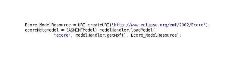

I'm working on a project which needs to lanch an owl2ecore atl transformation programmatically. In the transformation, I use the metamodel of Ecore in EMF Registry as metamodel of Ecore. In my code to lanch this atl transformation, I have problem to load the metamodel of Ecore. Here's my code to load the metamodel of Ecore :
index.php/fa/3183/0/
What should I do with this ?
Thanks very much.
Mingyi
