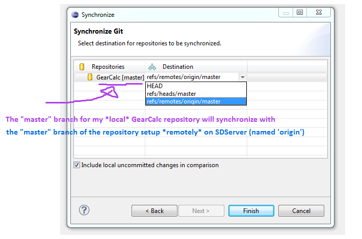

I have a repository setup remotely on a computer called SDSERVER. I have an eclipse project called GearCalc checked in to the master branch of this repository. I have imported a "Git Project" and am now synchronising for the first time.
I get asked to select a 'Desitination' as shown in the screenshot. Is my understanding which I have described in the attached screenshot correct? In other words, am I choosing the correct destination with the right thoughts in mind?
Thank-you in advance, Michelle

No. You are synchronizing with the remote tracking branch origin/master. This branch represents the contents of the branch master in the remote repository, but is also locally in your repository. You can update your remote tracking branch with the Fetch command. If you did that, then you synchronize against the contents of the remote repository (but still as a local operation).
Re: Setting up Synchronisation with Remote Repository [message #690254 is a reply to message #690229] Wed, 29 June 2011 05:28 Go to previous messageGo to next message
Yes yours understanding is correct.
You also need to remember that all changes that are in destination (in this case origin/master) will be marked as incoming and all changes that are in local master will be marked as outgoing.

Ok, then my understanding is wrong (since Dariusz wrote the whole Synchronizing thing, he is an expert in that, i don't use Synchronizing that much).
Re: Setting up Synchronisation with Remote Repository [message #690305 is a reply to message #690252] Wed, 29 June 2011 06:38 Go to previous messageGo to next message
It could sounds a little bit strange, but Manuel you are also right Wink
To clarify things. Before 1.0 synchronize view doesn't fetch changes from remote, because of that to get incoming changes you need to fetch them on your one. In 1.0 EGit will automatically fetch changes if given branch is remote or local branch has configured to track remote one.
