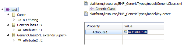

(I've attached a picture with this post, so you should find the details there.)
Anyway, I've made a very simple Ecore model consisting of a package test
with three classes: Super, GenericClass and GenericClass2. The latter two classes have a type parameter. Each of these classes has an attribute typed with the type parameter variable. I've also made a dynamic instance of GenericClass with the associated properties pane.
My question is, what does generics in the Ecore model actually mean (as illustrated in this case) and how can I use this construction explicitly in my model? I made a dynamic instance of S and loaded this as a resource in the editor. Then I tried to add this instance as the value for attribute2 of GenericClass2. This didn't work. Is there a simple example that illustrates how the generic types of my model can be utilised?
(Some thoughts: the generic feature of the metamodel is not "visible" in my .xmi-file. Why not?)

Does this model validate? It seems problematic that E extends Super and
hence must be some type of EClass but it's used as the type of an
EAttribute which must be an EDataType. I think attribute2 needs to be
an EReference.
Of Super you mean?
No, I'm sure you meant for attribute2 to be an EReference.
You've not set a value yet so there's nothing to serialize.
