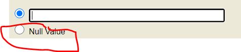

I have created three input parameters and do not want the fields to be required. I have unchecked the is required box for these parameters. I have added code to the beforeOpen on my dataset to deal with spaces or null value and I dynamically create my Where for my SQL statement. The issue that I am have is when the parameters are not required an extra Null Value selection appears whe a radio button. Is there a way that I can remove the Null Value selection? I want to allow the user to leave the text box empty or with text typed in. Thanks in advance for your help and time!

The problem that I have is my parameters are text boxes. The user is able to leave them empty or add some text. If I make them required it forces the user to input text and will not allow spaces. If I make them not required then I can accept spaces but I see the Text Box and the confusing Null Value radio button. I was just trying to make the Enter Parameters page to look cleaner by having text boxes that could have search text or empty for all text.

Re: how to remove Null Value. [message #1828121 is a reply to message #689498] Tue, 02 June 2020 03:21 Go to previous message
Jason Weathersby
Marc,
Understood. You should be able to remove it by modifying the the
TextBoxParameterFragment.jsp in the webcontent\birt\pages\parameter
folder of the viewer.
For the above your solution I need solution for the below posted question :
I need the solution for this what code exactly to remove from TextBoxParameterFragment.jsp file to remove the null value radiobutton from the parameters pop up for a Type text field
