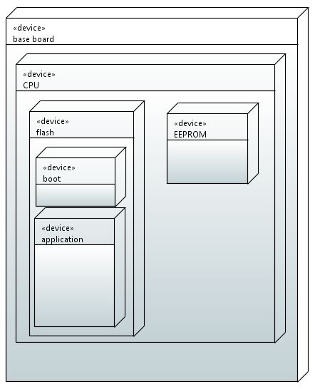

I have this question regarding a deployment diagram, Papyrus version 1.0.1.20140917:
How can I nest Device nodes more than two levels deep and show them in the diagram? I can create this kind of structure in the model view by adding child nodes, but when I drag a nested structure to a container device in the deployment diagram, only the top device is being shown inside the container device. (In my case the nested devices are "Real Time Model::base board::CPU::flash::boot".
By the way, I found a work-around. I created the devices bottom up. I created first a flash device and placed inside it a "boot" and an "application" device. Then I created an "EEPROM" and a "CPU" device. I then placed the "flash" and the "EEPROM" device into the "CPU" device, and subsequently the "CPU" device into the "base board" device. But I still wonder whether there is an easier way.
