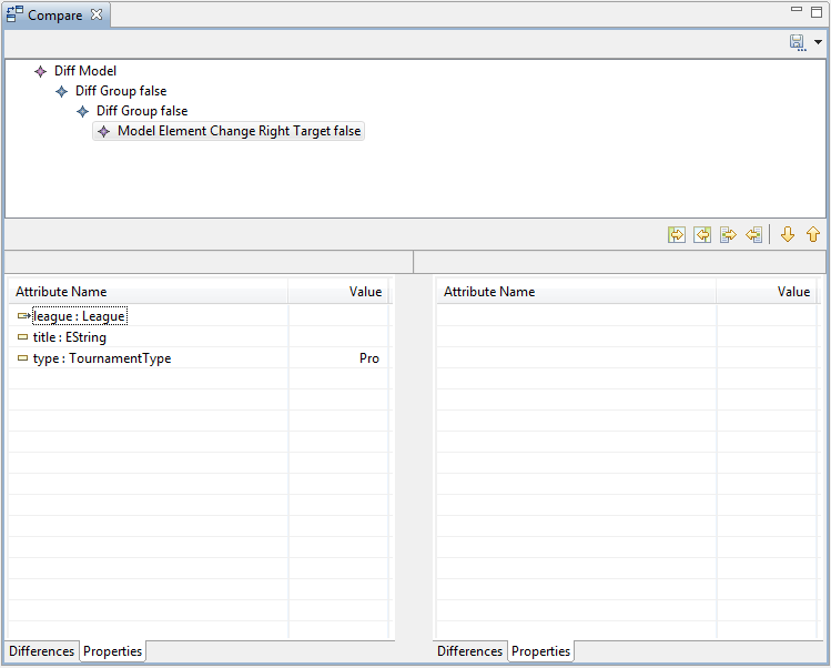

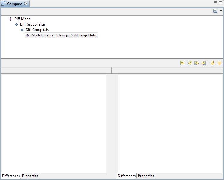

I am currently trying to create an emf compare editor view in an eclipse
plugin. What happens is that the elements of the tree, where usually the
structual changes are displayed, show some strange texts like "Model
Element Change Right Target false" (seems like the internal
description). And the visualization part is completely empty and only in
the properties view some entries are displayed.

Could you raise a bug against EMF Compare (https://bugs.eclipse.org/bugs/enter_bug.cgi?product=EMF&component=Compare) with the two screenshots you attached here and the code snippet that provoked it?
