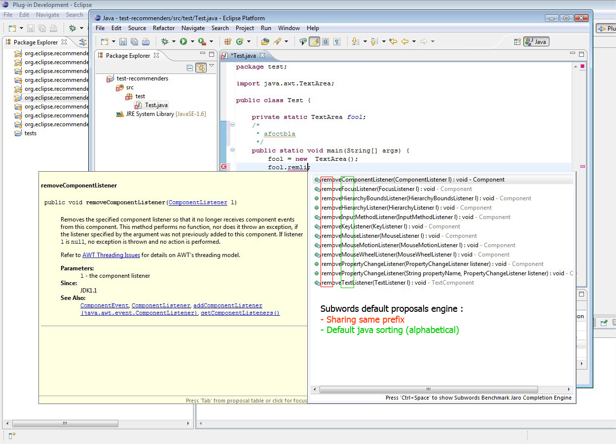

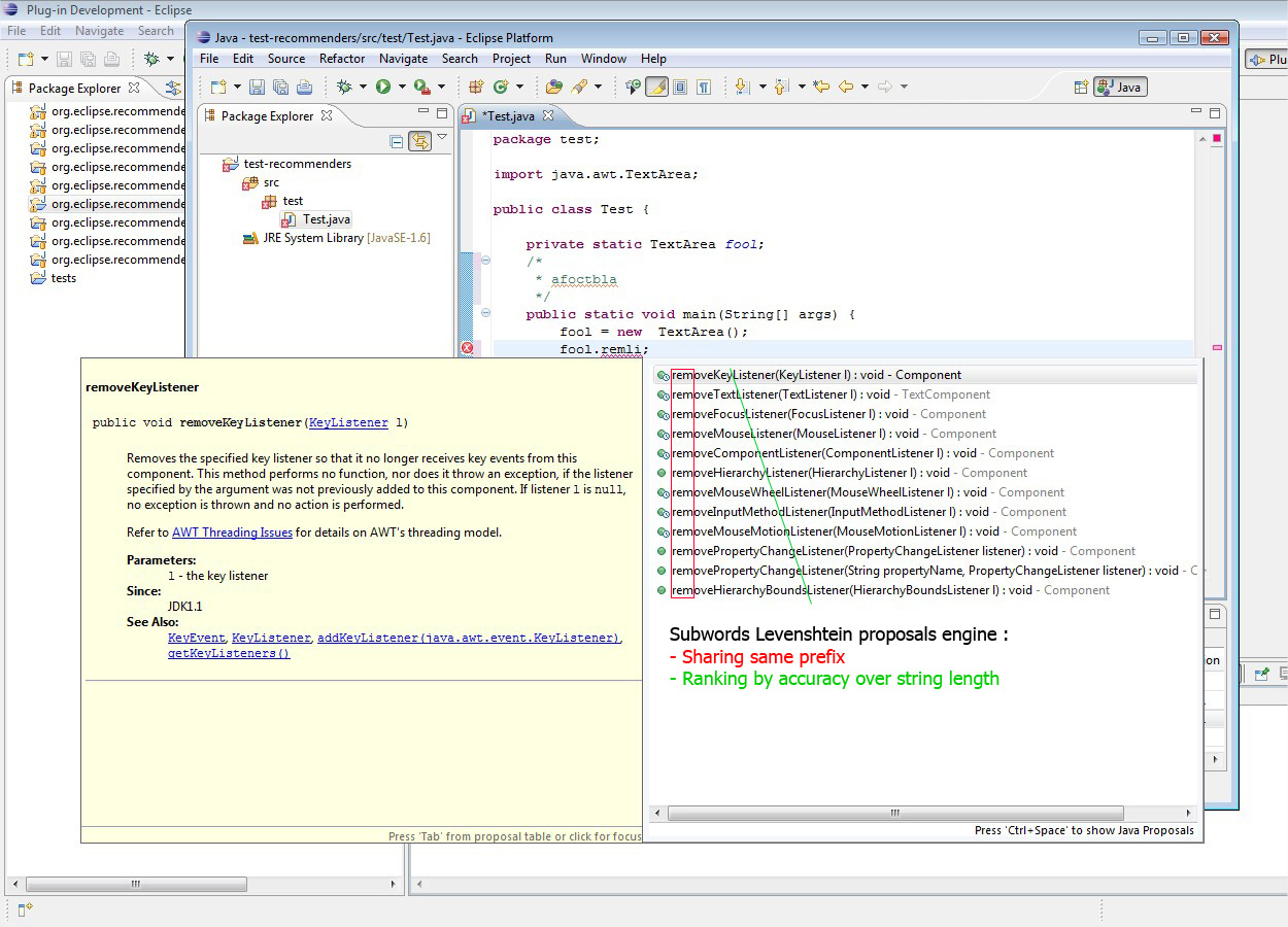

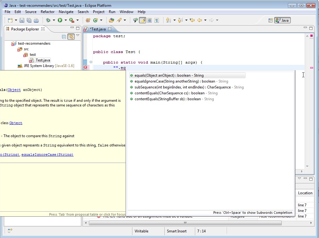

Well, I just finished implementing a "benchmark plugin" in order to compare proposals ranking algorithms efficiency. Results are very interesting.
Here is what I did : I added, besides default subwords proposals, two other engines that add relevance ordering on proposals using respectively Jaro-Winckler and Levenshtein algorithms (that I coded from scratch as needed by EPL, helped by descriptions found on the web).
I made some screenshots to illustrates all of this :
  • Default Subwords Engine
    index.php/fa/2919/0/

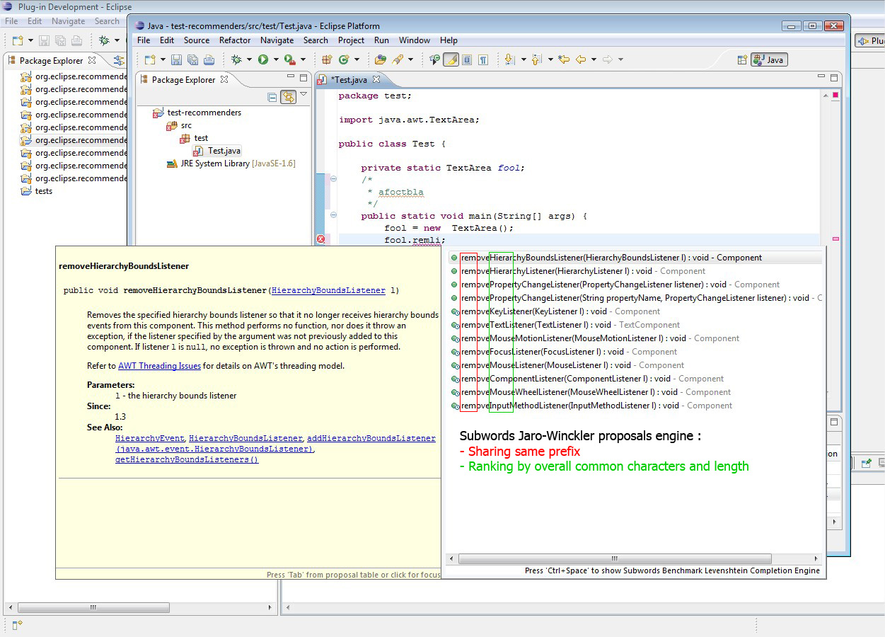

  • Jaro-Winckler algo.
    index.php/fa/2920/0/
  • Levenshtein algo.
    index.php/fa/2921/0/
As you can see, Levenshtein algo is very interesting to sort items by accuracy. In some cases, Jaro algo may be confusing (ends with melted results, less understandable). Thus, even if both algos compare strings letter by letter, Levenshtein's one seems to prior matching "subwords" as we intend it (successions of similar letters) while Jaro's one simply counts matching letters on the whole strings.
One major problem risen by this feature is that it mixes methods and fields proposals... It is quite frustrating when using completion. I think we will have to implement extra proposal sorter extension to keep original presentation (first methods, then fields...)
More tests have to be done to check possible limitations on multiple use cases but I can already say that I did not notice any performance loss in diplaying proposals. As images show, I tested on TextArea object that holds lot of items.
I can provide sources if you decide to check by yourself.
I am still running some tests to see how these algo behave with upper/lower-case characters and if they entirely take into account "subwords" as we need it.

Re: Help Wanted: Ranking Strategy for Subwords Completion Engine [message #676560 is a reply to message #673616] Sun, 05 June 2011 05:01 Go to previous messageGo to next message
Hello!

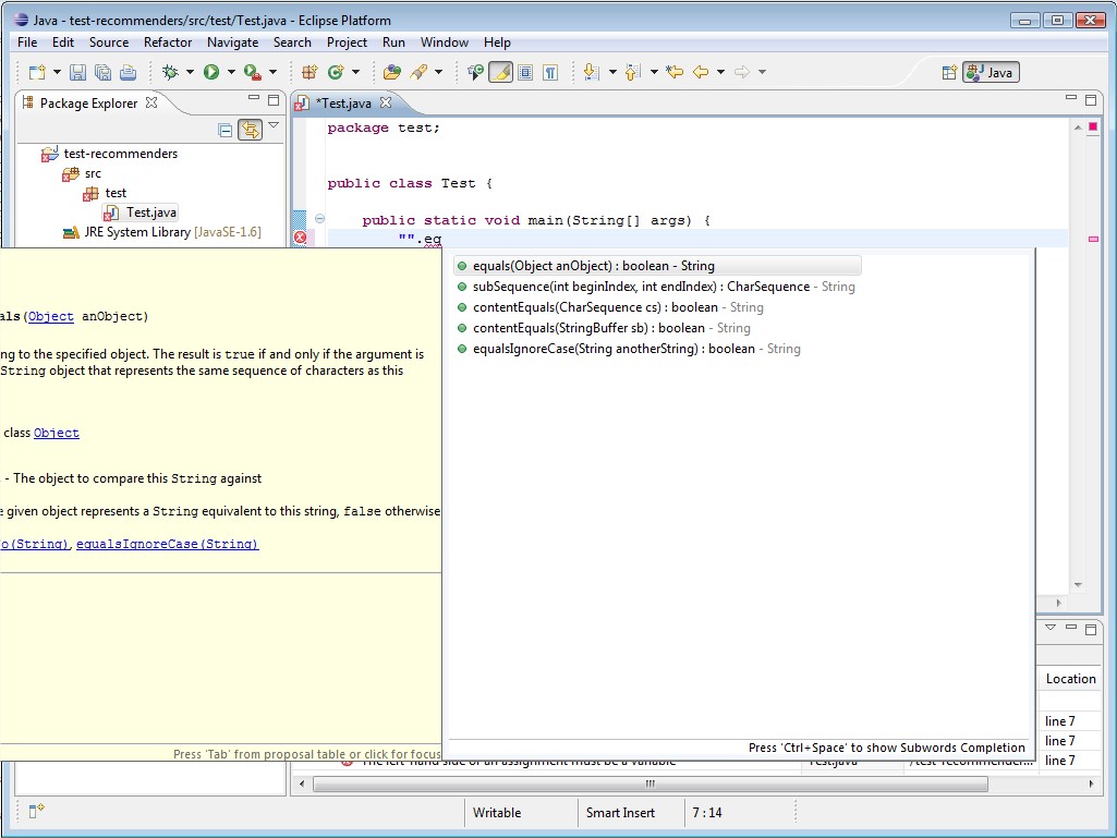

Some news about the algorithms. After some tests, I found some limitations on our current usage.
I worked mainly on Levenshtein's one since it seems to be cleaner for what we want (at least for now).
First limitation is that it lacks of weighting results on common prefix share : tell me if I'm wrong, but we want to prior proposals that share common prefixes, right? But here is what I have on a simple example :
index.php/fa/2938/0/
As you can see, "equalsIgnoreCase" is thrown to the bottom of the list due to its length... So, I tried to find an extension of this algo that could leverage results with common prefix length. I could not find precisely what I wanted (if you know some, please let me know) so I tried to add a home-maid calculation to get more precise results. Here is what I get :
index.php/fa/2939/0/
Now, Levenshtein result is leveraged with a common prefix care. I don't really know if my calculation is entirely correct, but it is quite simple and for now it seems quite acceptable.

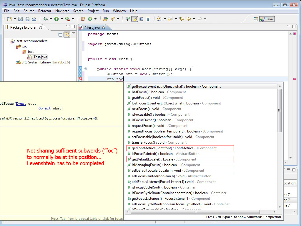

The second limitation is that Levenshtein does not really take into account subwords as we intend it. See :
index.php/fa/2940/0/
So I will try to find improvements, but keep me aware of what you about that...

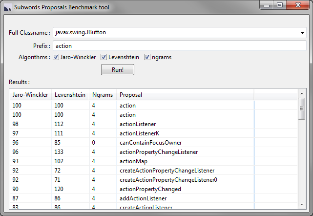

Re: Help Wanted: Ranking Strategy for Subwords Completion Engine [message #683485 is a reply to message #673616] Mon, 13 June 2011 16:55 Go to previous messageGo to next message
Following your advices, I created a little app to help us compare results generated by all algorithms, I mean simplier than the Eclipse plugins.
I joint an executable Jar file that launches a simple tool made to append proposals and differents results.
I'm going to make deeper tests in the next few days, but I provide you this tool that may help.
File is normally accessible here : http://fyels.com/ttK00p

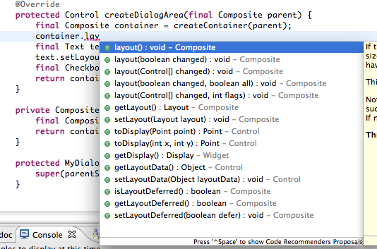

I just installed the subwords completion. This engine is great!
During my surface tests I found a situation I'm a bit surprised of the ranking results. Please have a look at the screenshot:
index.php/fa/3182/0/
Is there any special reason why "getDisplay" is ranked before "getLayoutData" ?

Re: Help Wanted: Ranking Strategy for Subwords Completion Engine [message #690729 is a reply to message #690604] Thu, 30 June 2011 01:46 Go to previous messageGo to next message
There is a reason. The weighting function gives a higher rank if the difference between token and completion string length is low.
In your case lay is shorter than both completions, so the shorter completion will be preferred. I asked in my previous post what the idea behind this is, as i am also surprised by the result.

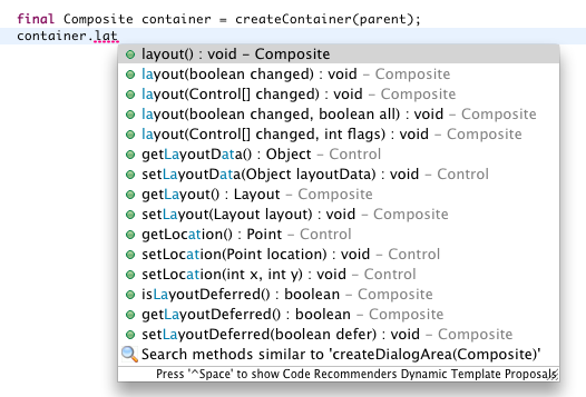

Re: Help Wanted: Ranking Strategy for Subwords Completion Engine [message #691307 is a reply to message #690756] Fri, 01 July 2011 03:51 Go to previous messageGo to next message
Just to keep you updated:
We updated the ranking strategies and also added a highlighting to subwords:
index.php/fa/3205/0/
You can install the latest version directly from the head update site (subwords feature). Your feedback is appreciated and always welcome!
