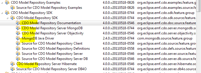

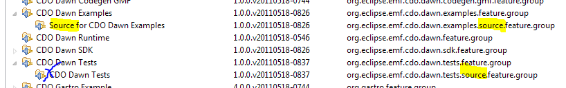

I noticed that some of my source features are generated without the "Source for " prefix while others have this prefix. I've attached two install screenshots that illustrate this problem. When I compare the "good" features with the "bad" ones I can see no relevant difference. Is there something i could have overseen or could it be a bug in Bucky?

I've attached the two files from the screenshot (2) for you. They look structurally identical and simple.

Am 19.05.2011 20:14, schrieb Thomas Hallgren:
> Do you see any other pattern?
It seems that the entire feature.properties file in the wrong source features is an *exact* copy of their code features. Also the description is wrong...
