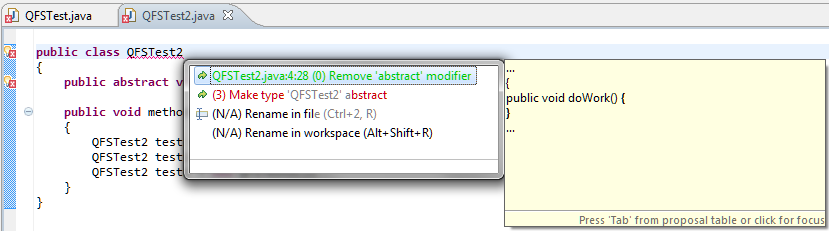

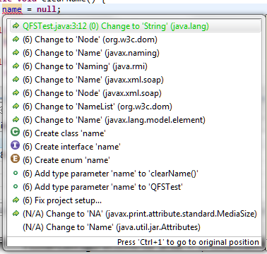

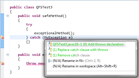

Thanks for the answer. The proposals I only get in the UI are the following:
Change to 'NA' (javax.print.attribute.standard.MediaSize)
and
Change to 'Name' (java.util.jar.Attributes)
I have also uploaded a screen shot that shows them in action (i.e., I put N/A on the left since I couldn't process them in the background).
Yes, that is me and I have been working on this project about 1 year. Due to limited API functionality, my current implementation mostly relies on the hooks I have put into org.eclipse.jface.text plug-in (i.e., I modify the source to call into my plug-ins, recompile it as a patch and put in Eclipse dropins folder).

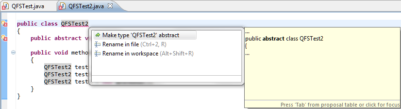

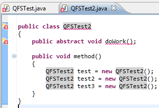

On 11/4/2011 11:58 AM, Kivanc Muslu wrote:
> It turns out that I actually haven't think about this before. However, after a little thinking and playing on the Eclipse, I come up with the following example. I have attached the pictures for the complete code, proposals offered with and without QFS (i.e., my analysis). The examples I have might seem unlikely, however I especially try to keep them as small as possible, so that the essence would be clear. I think that in complex situations such problems might arise.
Kivanc, if you invoke quick fix on the abstract method instead of the
class, JDT will propose 2 quick fixes
1. to remove the abstract modifier from the method
2. to make the type abstract
Now the 2nd quick fix can be thought of as a quick fix at another
location. When quick fix is invoked on the type I think it makes sense
to show only the quick fix which is offered by JDT i.e. Make the type
abstract (think of the case when there are many abstract methods)
Point is, quick fixes in JDT are implemented in such a way so as to
solve as many problems as possible. At least that is the intent, though
we may fail sometimes, for example in case of unresolved elements where
the quick fixes offered can be improved as your work has shown. But so
far I am struggling to come up with other examples.

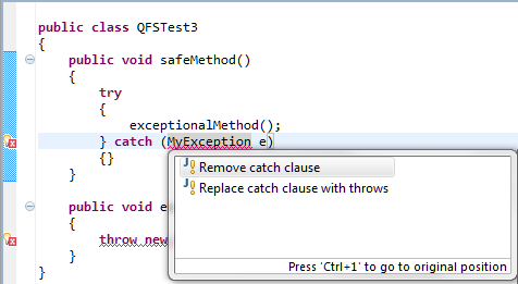

Hi Deepak,
I understand your point and concerns, however the fact that the extra proposals I add to the type itself also fixes the compilation error at that location (which is our metric to define if it is useful or not), seems still enough for me to add proposal 'Remove abstract modifier' to that location.
The way I see proposals is that they are produced to get rid of that local compilation error. In this example, another proposal (at another location) can also fix that local compilation error, so I still think it should be good to include for the developers. It also supports your saying that quick fixes are generated to fix as much compilation errors as possible (i.e., in this case the normal offering can only fix one compilation error), however the one I extract from the remaining compilation errors and add to top fixes all of them). If I missed something, please let me know.
Also here is another example for you Smile (again I am open to discussion) The screen-shots are attached. In this example, you can think the smart proposals as representing the following: doing an analysis inside the try block and seeing that there is a method used there. So the compilation error in the catch part can also be fixed by changing this method's signature by letting it throw the same exception that is caught (in our case MyException). If you also go and look at the method, you see that it already throws the same exception (however missing the throw declaration). So again, by extracting that proposal from the method to catch clause, I am hitting two birds with one stone (I hope Smile)
A more complete statement would be - Quick fixes are offered to fix as
many compilation errors as possible while making sure that the fix
offered is the 'right' one.
I still think that the 'Remove abstract modifier' example is not a great
one from a user's point of view.
> Also here is another example for you :) (again I am open to discussion) The screen-shots are attached. In this example, you can think the smart proposals as representing the following: doing an analysis inside the try block and seeing that there is a method used there. So the compilation error in the catch part can also be fixed by changing this method's signature by letting it throw the same exception that is caught (in our case MyException). If you also go and look at the method, you see that it already throws the same exception (however missing the throw declaration). So again, by extracting that proposal from the method to catch clause, I am hitting two birds with one stone (I hope :))
Now this is a better example! It goes significantly beyond what JDT
currently does and what JDT will probably do for the foreseeable future :)
Re: QuickfixProcessor vs. Eclipse UI Quick Fix [message #755631 is a reply to message #755613] Wed, 09 November 2011 01:47 Go to previous messageGo to next message

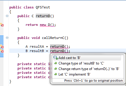

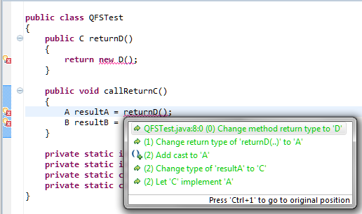

Hi Deepak,
I understand your argument with respect to user's point of view. Thanks for all the feedback!
currently does and what JDT will probably do for the foreseeable future Smile
Wow, this is great to hear (especially from you)! As I mentioned we also realized the power of smart proposals (a.k.a global best proposals), so this is fairly a new topic for us that we are investigating. I will try to come up with other meaningful examples for you and try to get your feedback on them. And who knows, maybe JDT can figure out another way (not through speculative analysis) to include those in the future Smile

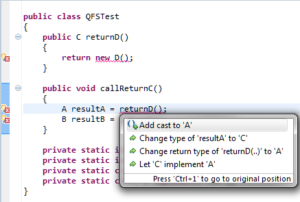

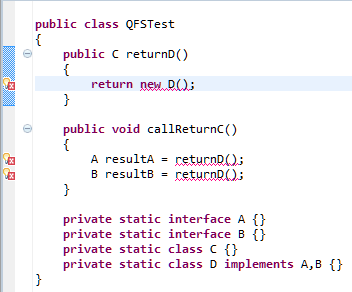

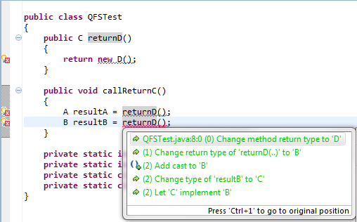

By the way, here is another example over sub-typing (kind of multiple inheritance - I know Java does not have multiple inheritance, however you could simulate similar sub-typing hierarchy by implementing multiple classes, as Eclipse source does all the time Smile)
The screen-shots are attached and the summary is as following: The developer mis-types the return type of a method. The method used in two different places and the return type is assigned to two different types (A and B). Eclipse by default only offers to change the return type to 'A' and 'B' respectively in the related places. However, the method returns D, which normally implements both. So, normally returning 'D' would fix all errors and this is normally offered in the method itself. However, at this moment, JDT does not try to look for the super-types of the left-hand-side of the assignment. With my current analysis, I can extract 'Change method return type to D' proposals from the method and offer it inside the other method (for both instances of usage). As usual, I appreciate your feedback, so let me know, what you think about this (by the way, maybe at least this can be implemented quite easily in JDT).
Re: QuickfixProcessor vs. Eclipse UI Quick Fix [message #755698 is a reply to message #755631] Wed, 09 November 2011 05:36 Go to previous messageGo to next message
This example is also reasonable. In essence you take into account all
errors in a project/file while proposing quick fixes for an error.
Currently, we don't do that in JDT. But I think the idea is useful, at
least in the 2 scenarios you have shown here. (...and I would really
like to see more concrete examples where such an approach is useful)
