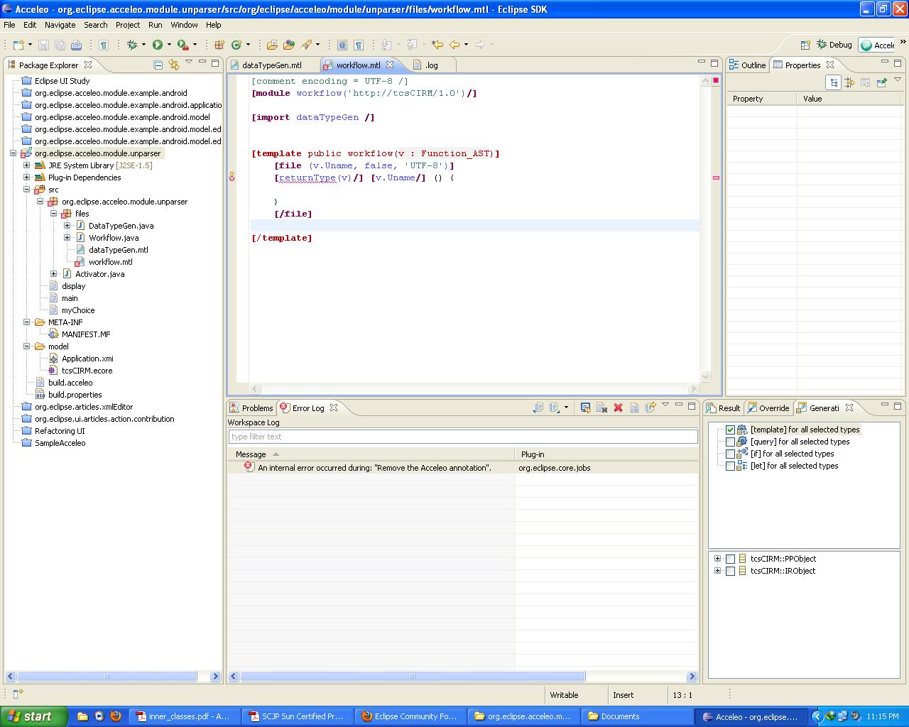

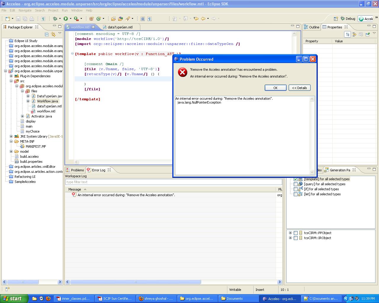

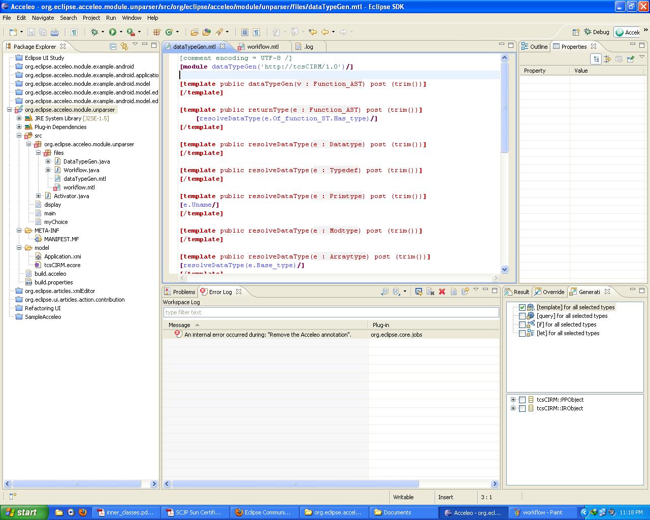

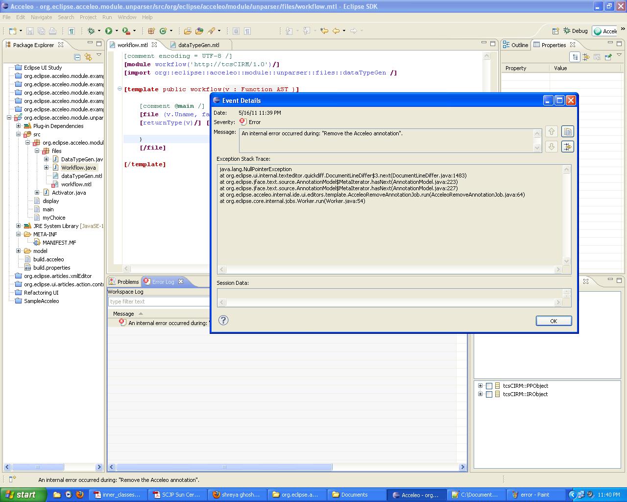

When I am using imports tag to import other .mtl module, It throws error as shown in attached file.
Each time I make a simple editing in editor marker becomes active to indicate error , but if I clean the project each time it works fine.
Please have a look at attached images

Hi Dharam,
The problem that you have is related to this bug: https://bugs.eclipse.org/bugs/show_bug.cgi?id=335761
It is a known issue in Acceleo 3.0.x and it has been fixed in Acceleo 3.1.0 which will be released next month.
I'll investigate the problem of the NullPointerException, but I think it was also fixed for 3.1.0
