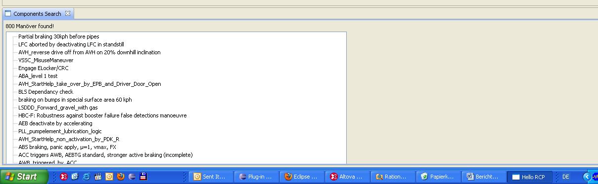

I have a simple use case, but I don't understand it don't work. I have a view and I want to add a Gridlayout to my view. It's look like that:
	public void createPartControl(Composite parent) {
		Layout l = parent.getLayout();
		Composite composite = new Composite(parent, SWT.NULL);
        GridLayout gridLayout = new GridLayout(1, false);
        composite.setLayout(gridLayout);
        GridData data = new GridData(GridData.FILL_BOTH);
        composite.setLayoutData(data);
        composite.layout();
        // add row to show the number of results
        Label resultInfos = new Label(composite, SWT.NONE);
        // add treeviewer
		resultTreeViewer = new TreeViewer(composite);
		resultTreeViewer.setContentProvider(new CSResultTreeContentProvider());
		resultTreeViewer.setLabelProvider(new CSResultTreeLabelProvider());
		Object result = Activator.getDefault().getComponentsSearchResult();
		if (result instanceof Set<?>){
			Set<?> input = (Set<?>) result;
			// set the number of results
			resultInfos.setText(input.size() + " Manöver found!");
			TreeNode rootNode = new TreeNode("root", null);
			boolean isNotNode = false;
			for(Object node:input){
				if (node instanceof Node){
					try {
						String nodeName = DomReader.getTextContent((Node) node, "MANEUVERNAME");
						TreeNode child = new TreeNode(nodeName, node);
						rootNode.addChild(child);
					} catch (XPathExpressionException e) {
						// TODO Auto-generated catch block
						e.printStackTrace();
				}else{
					isNotNode = true;
					break;
			if (!isNotNode){
				resultTreeViewer.setInput(rootNode);
The result is in the attached file.
I want that the treeviewer fill horizontaly my view and scroll vertically, when the number of results big is.
Thanks for your help

On 05/09/2011 09:55 AM, arthurembo wrote:
> Hi,
> @Override
Uh, you cannot set GridData on your composite (the layout data goes with
the parent layout, and the parent Composite is probably a FillLayout).
> composite.layout();
Don't do this ^^^^
> // add treeviewer
If you need to set layout data, you should set them on your label and
tree viewer controls.

Hi Paul,
thanks, it works fine now. I'm new in SWT and I don't really understand the layout mechanism. But now I learned really somethings.
Best regards
