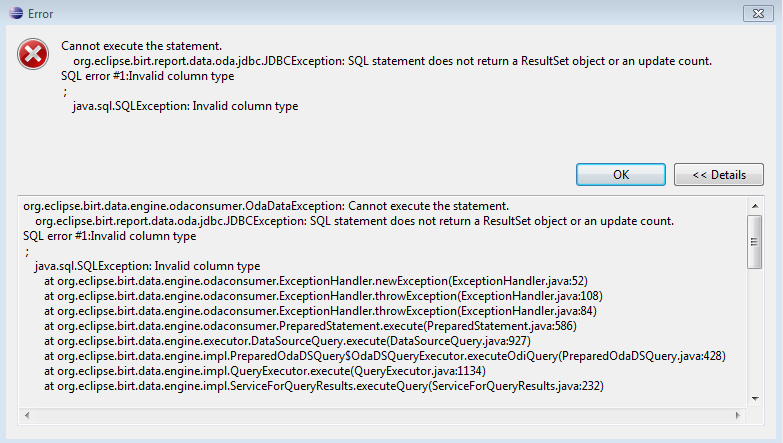

But I got the following error when I tried to preview the resutls:
A BIRT exception occurred.
Plug-in Provider:Eclipse.org
Plug-in Name:BIRT Data Engine
Plug-in ID:org.eclipse.birt.data
Version:2.5.2.v20100209
Error Code:odaconsumer.CannotGetResultSetMetaData
Error Message:Cannot get the result set metadata.
SQL statement does not return a ResultSet object.
SQL error #1: ORA-00903: invalid table name
If this works on the sqlplus command line, why doesn't it work within BIRT?
I thought the function returns a ResultSet object.
Can anyone pinpoint what should I be doing instead to call that function?

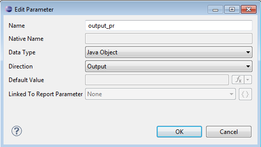

I have the following working under BIRT 2.3:
In Oracle:
create or replace package birt_support AS
type t_cursor is REF CURSOR;
END birt_support;
create or replace procedure get_stattest( outcursor OUT birt_support.t_cursor )
as
begin
open outcursor for select name, id, description, is_active, is_default, status_type from status;
end get_stattest;
In BIRT:
Create a new report with an Oracle datasource pointed to my schema.
Create a dataset of type SQL Stored Procedure Query
For the query, either drag and drop or directly enter:
{call ROME.GET_STATTEST(?)}
If you drag and drop, the parameter should be automatically created. Otherwise you will need to do that yourself. In either case you want to check that you have:
Parameter Name = outcursor
Type = Any
Direction = Output
I'll have to post the XML of my test report separately. You'll have to translate the data connection to your own environment, of course.

Re: Cannot call a function when creating a dataset [message #1603284 is a reply to message #658827] Thu, 05 February 2015 23:11 Go to previous message
Hello Richard,
I follow your example
Store procedure
PROCEDURE getAllStockModel( p_data OUT cursor_out)
IS
BEGIN
OPEN p_data FOR
SELECT * FROM stock_model;
END;
Query : {call getAllStockModel(?)}
Param: index.php/fa/20749/0/
=> error : index.php/fa/20750/0/
you can tell me why?
