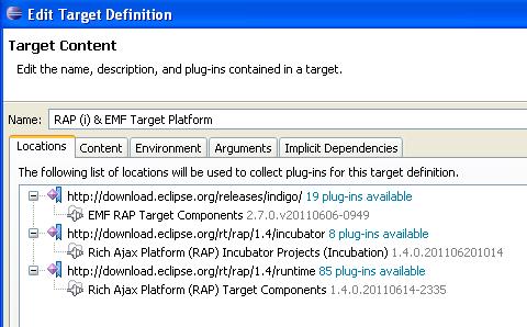

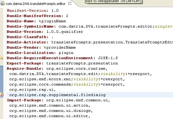

Re: rap file dialog [message #688078 is a reply to message #688045] Thu, 23 June 2011 17:14 Go to previous messageGo to next message
On 6/23/2011 12:54 PM, Ralf Sternberg wrote:
> Hi John,
> Just create a new target platform and include these two software sites:
> * http://download.eclipse.org/rt/rap/1.4/runtime
> * http://download.eclipse.org/rt/rap/1.4/incubator
> Then the bundle org.eclipse.rap.supplemental.filedialog will be
> available in your target platform.
> Hope this helps, Ralf
Ralf,
I created a new target platform from the above, along with the EMF + RAP
target, but the bundle was not found by eclipse. Attached are 2 jpegs,
one showing the target platform i've setup and the other the manual edit
I did to the manifest.mf (since the "Add..." buttons on the Dependencies
tab didn't show the bundle or package).

Re: rap file dialog [message #689702 is a reply to message #689564] Tue, 28 June 2011 04:06 Go to previous messageGo to next message
As I explained in the blog post, I'd recommend using Require-Bundle for org.eclipse.rap.rwt.filedialog here. Because of the split-package, Import-Package will not work here.
Re: rap file dialog [message #689916 is a reply to message #689702] Tue, 28 June 2011 11:11 Go to previous messageGo to next message
Ralf, sorry I missed that, but I have updated the manifiest and still
get the same error (java.lang.NoClassDefFoundError:
org/eclipse/swt/widgets/FileDialog).
I've tried several variants of the manifest (with and without the
fileupload in the Required-Bundle).
Manifest-Version: 1.0
Bundle-ManifestVersion: 2
Bundle-Name: %pluginName
Bundle-SymbolicName: com.datria.DVA.translatePrompts.editor;singleton:=true
Bundle-Version: 1.0.0.qualifier
Bundle-ClassPath: .
Bundle-Activator:
translatePrompts.presentation.TranslatePromptsEditorPlugin$Implementation
Bundle-Vendor: %providerName
Bundle-Localization: plugin
Bundle-RequiredExecutionEnvironment: J2SE-1.5
Export-Package: translatePrompts.presentation
Require-Bundle: org.eclipse.core.runtime,
com.datria.DVA.translatePrompts.edit;visibility:=reexport,
org.eclipse.emf.ecore.xmi;visibility:=reexport,
org.eclipse.core.commands;visibility:=reexport,
org.eclipse.rap.rwt.supplemental.filedialog,
org.eclipse.rap.rwt.supplemental.fileupload,
org.eclipse.rap.ui
Import-Package: org.apache.commons.fileupload;version="1.2.0",
org.apache.commons.fileupload.disk;version="1.2.0",
org.apache.commons.fileupload.portlet;version="1.2.0",
Re: rap file dialog [message #690039 is a reply to message #689916] Tue, 28 June 2011 16:36 Go to previous messageGo to next message
I'm sorry, John, I can't spot the problem. Sometimes a re-compile helps.
If not, what I would try next is to create a new Plug-in Project with an
simple snippet-like IEntryPoint implementation that contains a file
dialog. Add a bundle dependency to org.eclipse.rap.ui and to
org.eclipse.rap.rwt.supplemental.filedialog.
If this works, the problem must be in your code. If it does not, then
maybe there's something wrong in your target...
HTH, Ralf
