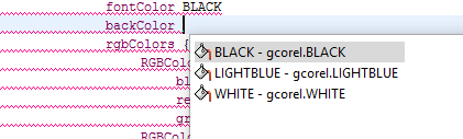

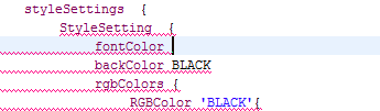

why in runtime I don't have any auto completion list for fontColor
index.php/fa/24775/0/
but for backColor I have a auto completion?
index.php/fa/24776/0/
Re: Splitting a model into several files? Scoping? [message #1721438 is a reply to message #1721432] Wed, 27 January 2016 08:33 Go to previous messageGo to next message
i asume you did a manual scope adaptation. sice xtext creates objects lazy your scoping method may never be called.
=> define the scope methodlike scope_Context_referenceName(AncestorOfContext ctx, EReference r)
or change your grammar to
StyleSetting returns StyleSetting:
	{StyleSetting}'StyleSetting'
  		'fontColor' fontColor=[RGBColor]
		'backColor' backColor=[RGBColor]
Re: Splitting a model into several files? Scoping? [message #1721446 is a reply to message #1721438] Wed, 27 January 2016 09:30 Go to previous message
