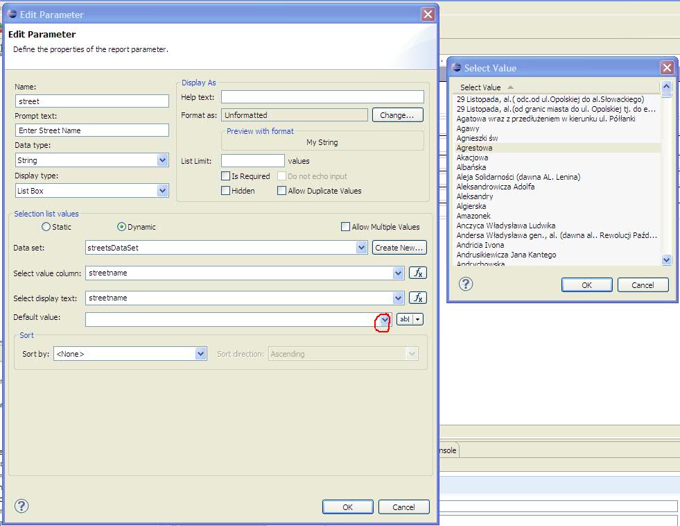

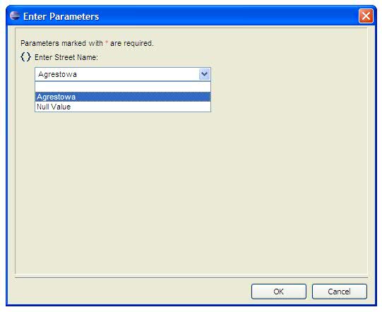

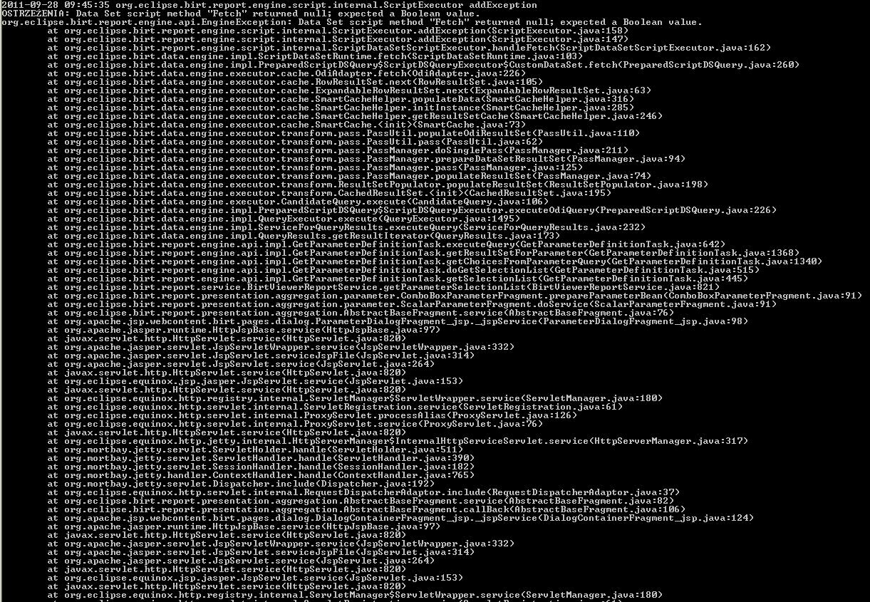

Re: Dynamic Parameter with Scripted Data Set [message #730336 is a reply to message #730099] Wed, 28 September 2011 03:53 Go to previous messageGo to next message
I tried 3.7 and it is exactly the same
Here are couple of screenshots:
As I said I'm able to select a default value for the parameter
http://student.agh.edu.pl/~mitrega/1.jpg
But when i run report it look like this:
http://student.agh.edu.pl/~mitrega/2.jpg
and stack trace of the error (unfortunately not whole and as an image Sad )
http://student.agh.edu.pl/~mitrega/3.jpg

Re: Dynamic Parameter with Scripted Data Set [message #730534 is a reply to message #730492] Wed, 28 September 2011 11:13 Go to previous messageGo to next message
Here are screenshots as attachments
