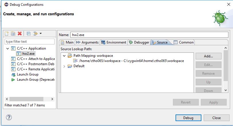

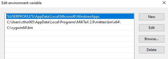

index.php/fa/32145/0/I had a very similar problem with a clean install of Eclipse using Oomph on my Win10 box. A compile & run of helloworld in Release worked fine. A compile in Debug produced an exe which I could debug by calling gdb within a cygwin console; but gdb would fail during its launch by Eclipse. My fix: I edited the Path environment variable of my Win10 OS, using Control Panel/System, to include C:/cygwin64/bin.
Another difficulty I had with the default Oomph installation was that it set C:/Users/myname/eclipse-workspace/ as my default workspace. That's a nightmarish place for a workspace of a cygwin project! Fix: I use a workspace in my cygwin/home directory. I'm still fiddling with a source-file Path Mapping in Debug/Configuration, for it seems that gdb (when launched from Eclipse) can't find the sourcefiles on a WIndows box until you give it some additional help with the Unix(cygwin)->Windows translation. Something like /home/myname/workspace -> C:\cygwin64\home\myname\workspace should work, but I haven't tested it fully so YMMV.
