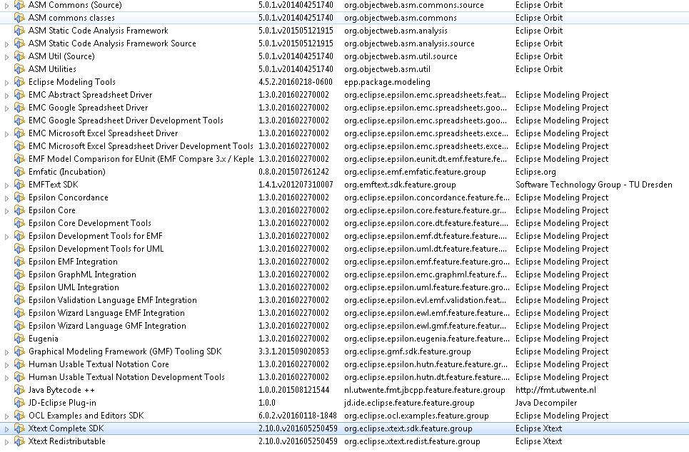

Hello Ed, I have experienced a similar problem. There is a reference list from A to B, in other words A has an attribute list<B> and this reference is set to be unique. I even put two OCL constraints stating the list should contain only unique elements (based on the element's id and based on the element's reference).
Despite all of this, I can create a model instance that has non-unique reference list and the validator validates successfully.
My Eclipse configuration is: Version: Mars.2 Release (4.5.2) , Build id: 20160218-0600.
Re: Property "Unique" for ecore attribute doesn't work [message #1746769 is a reply to message #1746762] Fri, 04 November 2016 07:28 Go to previous message
You're posting a very old thread. You talk about reference list from A to B and then talk about an attribute list and about setting unique. In general multi-valued references are always unique even if you set unique to be false. You claim you can create a model instance that has a non-unique reference list. But I don't know how you did that, and I can't verify anything like that without a test case. Your post contains no question and the image tells me nothing about your problem.
