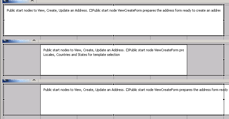

Please see attached picture. I have a refreshing problem with an EditPart
that shows a FlowPage as figure. The EditPart uses a slightly modified
ResizableEditPolicy. I'm wondering if I made some mistakes or forgotten
something.
When the EditPart is moved or resized, the selection border is not
refreshed. Any hints?
Thanks, Gunnar

FlowFigure overrides setBounds() to prevent its children from being
adjusted. (in the text package, bounds are updated bottom-up, instead of
top-down). I just added a call to fireMoved(), which should fix the
problem. You can try the fix yourself by doing:
page = new FlowPage() {
public void setBounds(Rectangle r) {
super.setBounds(r);
fireMoved();
