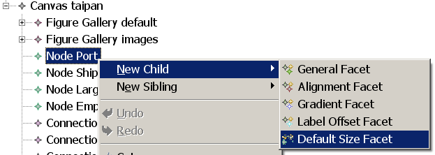

Re: Problems setting size of figures below 40 [message #61608 is a reply to message #61483] Thu, 12 October 2006 09:43 Go to previous messageGo to next message
Well, if "added to diagram element" is not enough... here's the picture

Originally posted by: jan.herriger.gmx.de
Thanks again. I knew where to add the facet. But the facet is
unavailable in version 1.0.1.
I installed Build: 2.0M1. Now, everything works fine.
