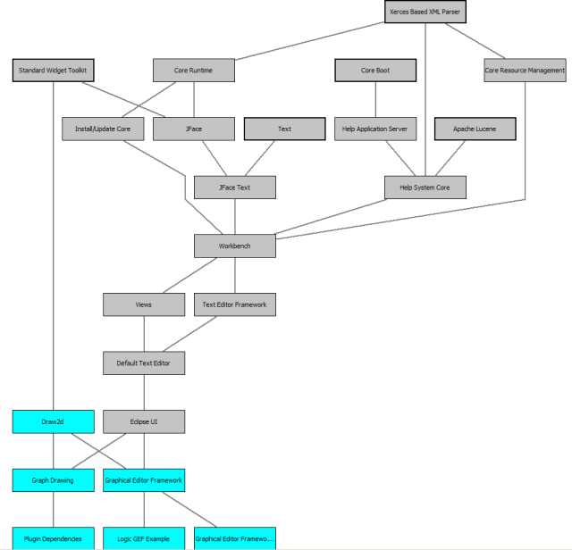

It's hard to manage dependencies without a picture. I've done some
experimental work in displaying the plugin depencies, based only on the
<requires> tags (See picture). As soon as I showed this to someone, they
immediately suggested that the "quality" of the requirement be expressed.
Meaning, show which classes require which other classes from the upstream
plugin. I feel like I'm having a hard time working this. Anyway, it might
be possible to show the resource-to-resource list of requirements (at
development time) by accessing the JDT compiler's dependency maps. Does
this make sense?

Why not use UML diagrams to show the dependencies? Then you could add
stereotypes (and possiblty tag/value pairs?) to the connections to
show qualities.
Have fun! - Bob

Along the lines of "Not support work items which have no hope of being
integrated into the Eclipse platform", I was thinking of a simple extension
to the current PDE dependency view (which I remember in 2.0, but can't seem
to find in 2.1). I don't think a full-blown UML editor is on the 2.2 or
even 3.0 plan. Also, *plugin* dependencies are strictly directed and
acyclic, so an automatic layout of the plugins is possible. This means that
such a "tool" could function without any additional information or resources
other that the plugin.XMLs.

Okay, then why not use a true acyclic directed graph picture? That
would include arrows to indicate direction and probably names for the
nodes and edges.
BTW, I wasn't suggesting a UML editor - I was suggesting drawing the
picture in UML because that's become the standard language for
software design materials, and this is one of those. Also, only a
very small subset of the language would be needed for this
application....
Thanks and have fun! - Bob
>upstream plugin.
This is already supported in PDE since a while.
In the depency view or the manifest editor's
Dependency tab you can select a required plugin and
execute "Compute Dependency Extent". This will show
you the types required from the pre-req by this plugin.
There is also a "Find Unused Dependencies" action. It will
report which pre-reqs are potentially not needed. This
helps you to clean-up and minimize your pre-reqs.
--erich
