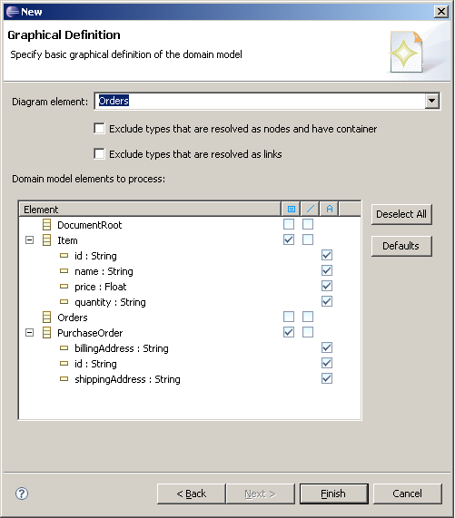

When I generate the gmfgraph and select Orders as the Diagram Element it
does not show any links. A screen shot of the Graphical Definiton dialog is
attached.
Aniruddh

Originally posted by: 5d5.mail.ru
References were not recognized as links since they are containments; I
could suggest to use GMF 2.0 or simply add link figures and tools by
hand (I mean using editors generated by EMF).

>>> I created a new EMF Model from the XSD, then generate the model code and
>>> the Edit Code. After that when I create .gmfgraph, in the Graphical
>>> Definition dialog I can only see DocumentRoot, Item, and PurchaseOrder.
>>> There are no attributes under Item. Continuing further when I generate
>>> the
>>> diagram code I get the following error.
>>> The method setnull(DocumentRoot) is undefined for the type DocumentRoot.
>>> Thanks & Regards,
>>> Aniruddh

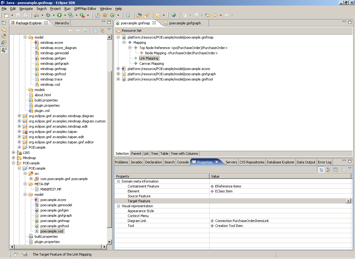

Originally posted by: achitre.megawareinc.com
I added a Ployline Connection, a Connection, and a Compartment in the
..gmfgraph. Now when I create the generator model it gives me an error saying
that the targetmetafeature has not been set. I saw a a similar problem
reported in this group. In my gmfmaps link mapping the Target Feature is
empty. What should it be set to? In the mindmap example the Target Feature
shows EReference's in the model. In my case its only showing the attributes.
A screen shot is attached. Can someone tell me the significance of this
property and how to make sure that it has the proper value.
Thanks & Regards,
Aniruddh

Re: GMF Modelling Beginner question [message #57581 is a reply to message #57478] Fri, 29 September 2006 09:00 Go to previous messageGo to next message
Your screenshot shows you are trying to use Item as a link (often referred
to "link as class"). What you need to do is to have another top level node
mapping for item, and for the link mapping, leave containment and element
fields blank and put 'items' reference as target metafeature.
Artem
>>>> it
>>>> dialog is
>>>> attached.

>>>> "Artem Tikhomirov" <artem.tikhomirov@borland.com> wrote in message
>>>> news:efbooj$h6h$1@utils.eclipse.org...
>>>>> You need either choose PurchaseOrder as a top item or introduce
>>>>> another
>>>>> container, e.g. Orders. DocumentRoot can't be used as an element of
>>>>> domain
>>>>> model
>>>>> Artem

Re: GMF Modelling Beginner question [message #59469 is a reply to message #58635] Thu, 05 October 2006 08:14 Go to previous message
You've got top level node for the 'PurchaseOrder', and I suggested to have
similar one for 'Item' domain element. We are talking about changes to
..gmfmap file, which is the model that actually describes what's link and
what's node in your domain.
Artem
> news:efj57b$7p8$1@utils.eclipse.org...
>> referred to "link as class"). What you need to do is to have another top
>> level node mapping for item, and for the link mapping, leave containment
>> and element fields blank and put 'items' reference as target metafeature.
>> Artem
>> "Aniuddh Chitre" <achitre@megawareinc.com> wrote in message
>> news:efj14p$g6h$1@utils.eclipse.org...
>>> Hi,

>>>> Aniuddh Chitre wrote:
>>>>> Hi,
>>>>> I have modified the schema as follows.
>>>>> <?xml version="1.0" encoding="utf-8" ?>
>>>>> <xsd:schema targetNamespace="http://www.poexample.com/gmf/poexample"
