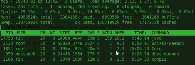

This post seems to be contemporary and still valid, because one year later, I still have to cope with this problem.
Quote:I'm having exactly the same problem, but on Ubuntu Lucid x64, both with OpenJDK and Sun's Java. Eclipse Helios is thus absolutely useless. After some weeks of discovering various bugs I wonder if anybody's ever even tested this or if it was just packed and offered as a download.
Same configuration, same problem.
Workstation I7
Ubuntu Lucid 64 bit
OpenJdk or Java selectable.
4GB of RAM
No matter how big is the file opened.
I think with some test I could find the exact operation to do to create the 100% CPU (core) freeze. At the moment it seems related to PHP validator because it seems to happen when I'm writing and stop for a moment with a line left uncompleted... something like
$a="blah blah blah' .
"blah blah
Whatever the case, the problem ends up with Java process 100% CPU load (in the case below 199% )
Attachment: javaloop.jpg
(Size: 57.11KB, Downloaded 9868 times)
