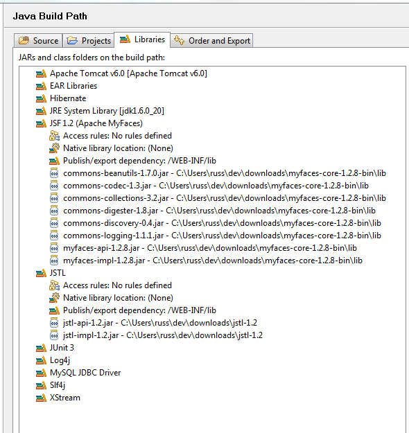

Please see the Eclipse console error excerpt at
http://www.javahotchocolate.com/trouble/server-start-error.h tml
Please see my Build Path particulars at
http://www.javahotchocolate.com/trouble/build-path-particula rs.png

Have you verified that the myfaces jar that contains the
StartupServletContextListener (I assume myfaces-impl-1.2.8.jar) is
present in the published webapp? If so, the problem would seem to be
local to Tomcat and enabling some logging might be the best next step to
diagnose. If the jar is missing, then we would need to try to determine
why WTP server publishing is causing it to go missing.

Yes, that's the first thing I did. It's myfaces-impl-1.2.8.jar that
contains the listener. I think that's why it's intermittent: it
occasionally works when planetary and stellar alignment appears propitious.

The "JAR" would be the one in the WEB-INF/lib of your webapp down under
" .metadata\.plugins\org.eclipse.wst.server.core\tmp?\wtpwebap ps ".
This one would be the one being used by Tomcat at runtime and in which
it would expect to find the class. Normal publishing would copy it once
and not re-copy it unless a "full" publish occurred. Corruption of this
jar is the only simple explanation I can think of as to why the problem
"sticks" once it occurs. If the jar is still intact, I would think the
problem would be hit or miss.
If jar corruption isn't it, then I don't have any good guesses as to
what the cause is, especially since it sounds like this is happening on
multiple machines. Have you had any issues with any poltergeists lately? :)
Note that this ClassNotFoundException thrown from line 1516 of
WebappClassLoader of Tomcat 6.0.26 is the "I give up"
ClassNotFoundException. It's conceivable that the internal attempt to
load the class which should have succeeded, fails due to some problem
other than the class not being found. The "search" to load the class
could continue and the "real" problem goes unreported. The purpose of
the logging.properties file is to hopefully log that internal load failure.
