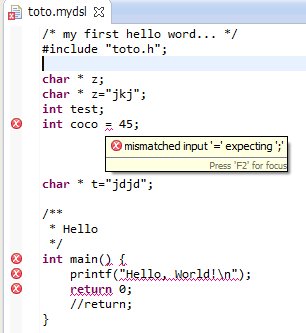

Re: Lookahead value of xtext grammar [message #871495 is a reply to message #52382] Mon, 14 May 2012 04:47 Go to previous messageGo to next message
I am stress testing tmf xtext with a little large grammar.
I have to parse it with lookahead value 4 bceause lookahead =1 is not
enough for the nature of grammar.
How can I specify the lookaheadSSSSS valueSSSSS ?
I personnaly need a lookahead (options {k=1;}) value for each branch of grammar, instead of just root (changing it in mwe2 doesn't cover full grammar but just from root of it)
I don't find a way in order to do that.
stress used : C.g grammar from Terence Parr ( ANTLR=>grammar=>C Preprocessor )
C Hello Word failed on Xtext.
Fail example :
int toto = 45;//failed
int * toto = 45; //correct
Rules failing here :

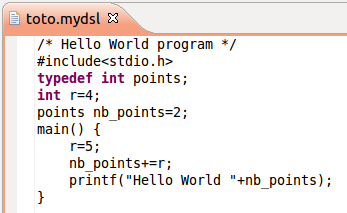

Re: Lookahead value of xtext grammar [message #873962 is a reply to message #873262] Sat, 19 May 2012 11:54 Go to previous messageGo to next message
Hi Sebastian,
I founded a semantic predicate on C.g, k parameter didn't affect here (k no sense here). I read somewhere that semantic predicate are not implemented on Xtext.
It is ok for me, to compare Xtext/model and ANTLR/semantic-predicates is like comparing DOM and SAX Cool
I think that LL(*) just cover LL(k), with or without using backtrack.

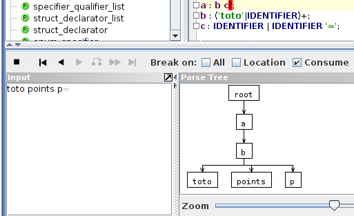

Problem here came just from a special case where ANTLR crap itself :
index.php/fa/9780/0/
a : b c?;
b : ('toto'|IDENTIFIER)+;
c : IDENTIFIER | IDENTIFIER '=';
toto points p=
index.php/fa/9781/0/
Thanks a lot for your help,
Renaud

I'm not sure exactly what you expect right now. What I got is that you
face some issues with the migration of a rather complex, pure Antlr
grammar to Xtext.
The given snippet is obviously ambiguous since the input
toto points
may either be
a [ b [ 'toto' points ] ]
or
a [ b [ 'toto' ] c [ points ] ]
thus Antlr will give you some warnings if you disable backtracking and
remove some alternatives from your grammar. This leads to the parse
errors for toto points p=.
Sebastian
Need professional support for Eclipse Modeling?
Go visit: http://xtext.itemis.com
Am 19.05.12 17:54, schrieb Renaud Helias:
> Hi Sebastian,
> memoize parameter is just a optimisation parameter that didn't have any border effect.
> a : b c?;
> toto points p=
> Renaud
