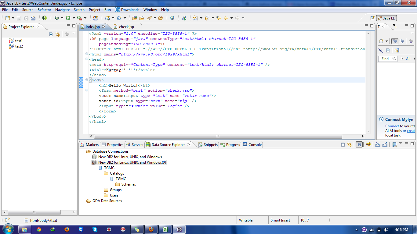

icon6.gif  Re: How to view tables, stored procedure etc in DTP [message #1028507 is a reply to message #490096] Thu, 28 March 2013 06:50 Go to previous messageGo to next message
hi,
I'm facing same kind of problem.
I'm using helios java EE IDE and DB2 version 3.0.0.3.
I'm able to connect my database server and schema. But when i expand schemas nothing is shown.
I'm new in web development and eclipse.
Please help me out.
I'm also attached a screen shot of the eclipse IDE window...
Urgent reply needed.
