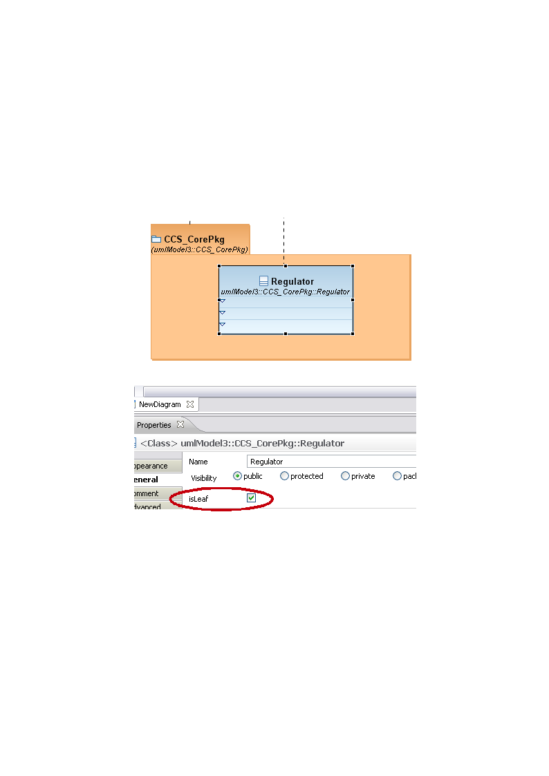

in UML2, I think that this concept is supported by the isLeal attribute of a
RedefinableElement. So for a Class (which is RedefinableElement) in Papyrus,
you just need to check the check box of the isLeaf properties as shown in
attached picture.
Regards... S

Actually, I believe that for Java's final *fields*, it would correspond
to StructuralFeature.isReadOnly ("whether the feature's value may be
modified by a client").
RedefinableElement.isLeaf ("whether it is possible to further specialize
a RedefinableElement") seems to correspond to Java's final classes or
methods.
So I guess the question is whether Papyrus exposes isReadOnly for
structural features.
Rafael
