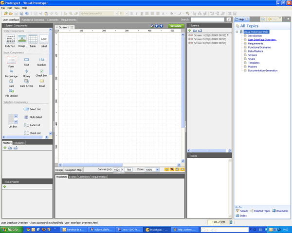

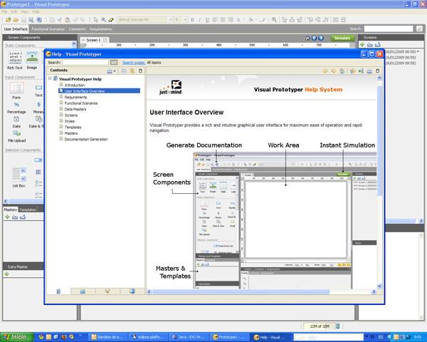

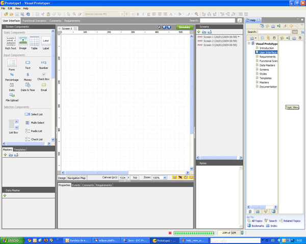

Re: Dynamic Help not working [message #475082 is a reply to message #475079] Mon, 26 January 2009 03:10 Go to previous messageGo to next message
Originally posted by: victor.conesa.justinmind.com
Ok, while I found the way to post a bugzilla I send the images through this
mail.
The first image shows the standalone help working properly. The second one
shows the dynamic help and the list of topics working properly too. The
third one shows what happens if I click on a topic in the help view, as you
could see the contents are not displayed and the topics tree is visible, but
in a Mylyn topic (if I run the product adding this plugin), that tree doesnt
appears and the content is displayed correctly. So I supose is something
related to the help system configuration of my product but I can't see where
is the error.
Thanks.
mail.
is the error.
Thanks.
Hi all,
It's solved. The problem was some code in the html files. We are not really
sure why there was that piece of code in our help files but everything work
perfectly well without it. The piece of code was:
<script>if( self == top ){ window.location.replace(
" ../../../index.jsp?topic=/org.eclipse.help.base/doc/help_hom e.html ");}</script>
Thanks for your answers Chris,
