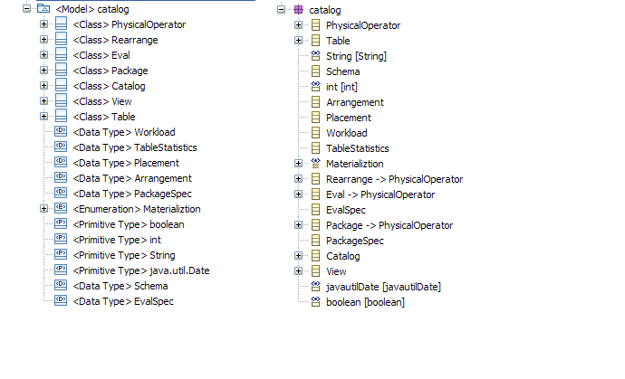

Re: No primitive types in .ecore files (party.javalang.String, ...) [message #472794 is a reply to message #472751] |
Tue, 24 April 2007 22:07 |
james bruck Messages: 1724 Registered: July 2009 |
Senior Member |
Hi Pradeep,
some comments below ...
- James.

> Also, when I import uml model to ecore, classes are being created for
> DataTypes in the uml model as well. Is there a way to avoid that?
If you define the Datatypes in your .uml model they will be created in the
..ecore model.
> The importer doesn't seem to differentiate between Class and Datatype.
... not sure what you mean by "differentiate between"?

Re: No primitive types in .ecore files (party.javalang.String, ...) [message #472795 is a reply to message #472794] |
Tue, 24 April 2007 23:22 |
Eclipse User |
Originally posted by: pradeep_tamma.yahoo.com
Please see the attachment. I am using uml2tools in eclipse. I created some
Datatypes, some primitive types and some classes using the graphical editor.
Now in the .uml file you will see those primitive types, DataTypes and
Classes. But when I import the same as ecore, there is no difference between
DataTypes and classes.
Also for the primitive type, java.util.Date in uml file changed to
javautilDate.
When I generate classes using the genmodel I get classes for Datatypes as
well. As expected javautilDate gives an error.
Please let me know if I am not clear.
Pradeep

"Pradeep Tamma" <pradeep_tamma@yahoo.com> wrote in message
news:f0m3f0$acg$1@build.eclipse.org...
editor.
between
> javautilDate.
> Thanks
> Pradeep
> There

Re: No primitive types in .ecore files (party.javalang.String, ...) [message #472804 is a reply to message #472797] |
Wed, 25 April 2007 21:45 |
Pradeep Messages: 61 Registered: July 2009 |
Member |
Hi James,
I assume by type you mean an actual Class. But I don't see an option to
specify a stereotype in the diagram editor. How do i specify it?
Pradeep

Re: No primitive types in .ecore files (party.javalang.String, ...) [message #472805 is a reply to message #472804] |
Thu, 26 April 2007 09:19 |
Tas Frangoullides Messages: 195 Registered: July 2009 |
Senior Member |
Pradeep,
My guess is James meant for you to create a UML Primitive Type as this is
where you can apply the <<eDataType>> stereotype.
Incase you don't have the profile here are the steps.
First you need to apply the ecore profile: Click on your model and use
Package->Apply Profile..
Then you need to apply the stereotype: Click on the primitive type and use
Element->Apply Stereotype..
The additional properties provided by the stereotype will appear in the
properties view under the "EData Type" category
Hope that helps.

Re: No primitive types in .ecore files (party.javalang.String, ...) [message #611045 is a reply to message #472749] |
Tue, 24 April 2007 21:14 |
Senior Member |
Hi Gonzalo,
I'm not sure how Omondo handles these types but opensource UML implements a
XMLPrimitiveTypes.library.uml and UMLPrimitiveTypes.library.uml that should
be used.
You can experiment with the opensource editor by typing your properties with
primitive types coming from these libraries and then generating your .ecore
model.
That should work.
You can alternatively stereotype your primitive types with <eDataType>
(from the ecore profile) and specify the instance class name explicitly.
- James.

Re: No primitive types in .ecore files (party.javalang.String, ...) [message #611049 is a reply to message #472751] |
Senior Member |
Hi Pradeep,
- James.
news:f0lt0b$e1n$1@build.eclipse.org...
> I also have the Date problem mentioned below.
.. see previous posting for some suggestions ...
..ecore model.

Re: No primitive types in .ecore files (party.javalang.String, ...) [message #611050 is a reply to message #472794] |
Eclipse User |
javautilDate.
Pradeep
There

Attachment: uml.PNG
(Size: 29.77KB, Downloaded 143 times)

UML Primitive types map to ecore DataTypes.
UML Data types map to ecore Classes.
Ecore does not make distinctions between UML primitive types and UML data
types.
The name of your java.util.Date is not an appropriate ecore metatype name so
the periods were removed. I think what you really want to do is create a
type called "Date", then use a <<eDataType>> stereotype and set the instance
class name to java.util.Date. Or use the primitive types libraries as
mentioned previously.
- James.
editor.
between
> javautilDate.
> Thanks
> Pradeep

Pradeep,
Hope that helps.

"Tas Frangoullides" <tas.frangoullides@barclaysglobal.com> wrote in message
news:f0pqrv$kqd$1@build.eclipse.org...
> Pradeep,
> Hope that helps.
> This thread has reminded me of a something I've been meaning to ask...
> I'll pop it in another thread.
> Tas.
>>> name so
>>> a
>>> instance
>>> - James.
>>>> some
>>> editor.
>>> between
>>>> javautilDate.
>>>> as
>>>> Thanks
>>>> Pradeep
